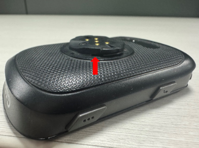

Side of the Mount
Baro port located on the side of the mount

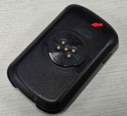

On the Back
Baro port located on the back of the Edge

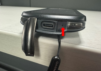

Under the Weather Cap
Baro port located under the weather cap
NOTE: The Edge 1040 barometer is located under the weather cap. This is okay to rinse under water, as long as the USB-C port is completely dry before replacing the weather cap or charging.
