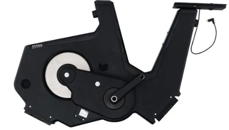

After completing steps 1-6, your NEO Bike Series frame should look like the following:
how the Neo Bike Frame look before Repacking
