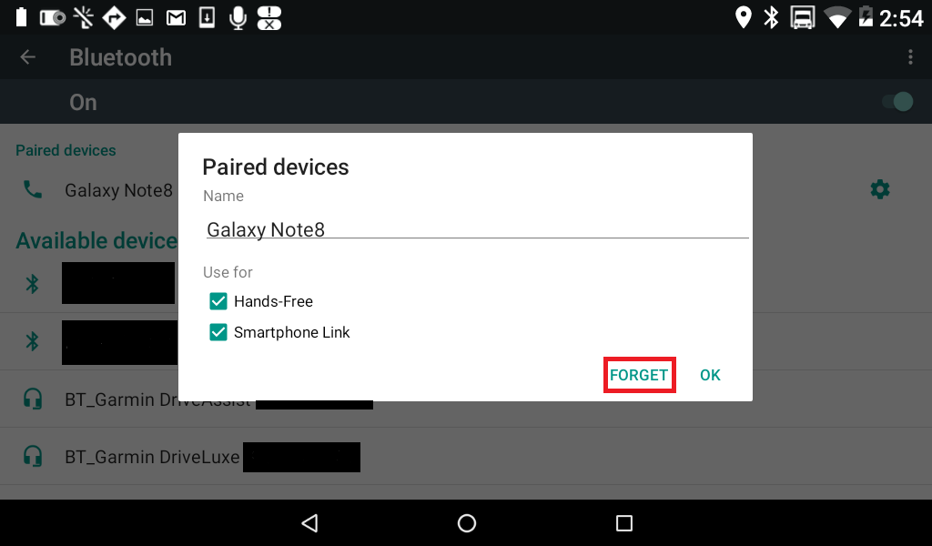

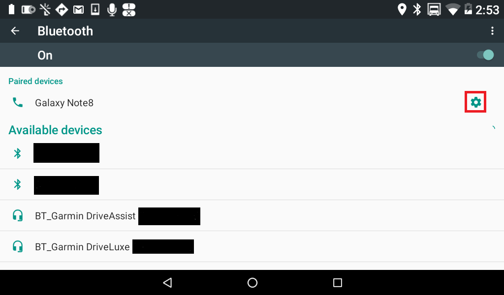

Clear Pairing History
- Clearing the pairing history on the automotive device and the phone will establish a new Bluetooth session between the devices. Step-by-step instructions for clearing the pairing history can be found below.
1. | Touch the Gear Wheel | |
2. | Touch Bluetooth | |
3. |
Touch the Gear Wheel next to the device to delete
4. |
Touch Forget
