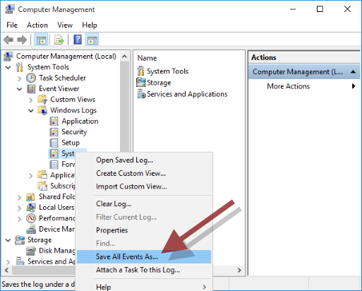

  1. Click on the search box at the bottom of the desktop of your computer type computer management and press Enter.
  2. In the Computer Management window, click the arrow next to Event Viewer.
  3. Click the arrow next to Windows Logs.
  4. Right-click Application and select Save All Events As…
  5. Save the .evtx file to your Desktop with the name Application.
  6. Right-click System and select Save All Events As…
  7. Save the .evtx file to your Desktop with the name System.

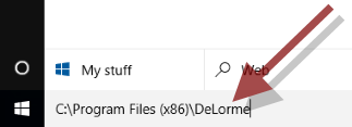

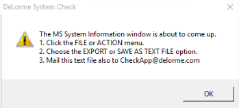

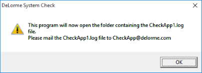

  1. Click on the search box at the bottom of the desktop of your computer type C:\Program Files (x86)\DeLorme and pressEnter.
  2. Double-click the folder for the program experiencing an issue to open it.
  3. Double-click CheckApp1.exe.
  4. Click OK in both DeLorme System Check windows as they appear.

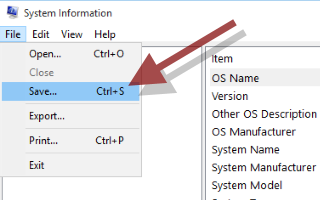

    Two windows will appear, a Windows folder containing the CheckApp1.log file and the System Information for the computer.
  5. In the System Information window click File and then Save.
  6. Save the .NFO file to your desktop with the name System Information. Make sure to Save and not Export this file.
  7. Select all available files displayed in the Windows folder and copy and paste these files to your Desktop.

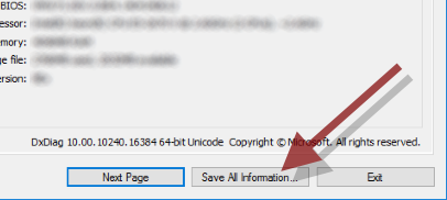

  1. Click on the search box at the bottom of the desktop of your computer type dxdiag and press Enter

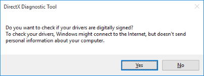

    Note: If this is the first time you have used the DirectX Diagnostic Tool, you will receive the message below. You may choose either option as it will not affect the log created.
  2. Click Save All Information.
  3. Save the DxDiag.txt file to your Desktop.

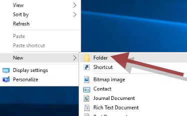

  1. Right-click on the desktop, select New, and then select Folder.
  2. Name the new folder Logs.

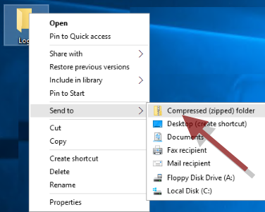

  4. Right-click the Logs folder, select Send To, and then select Compressed (zipped) folder.
