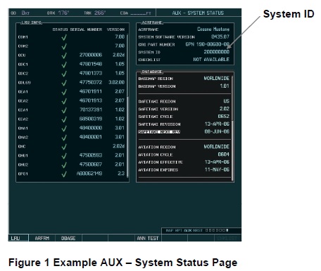

All GDU 1XXXs with a GDU software version of 7.00 or greater and a System ID of “00000000” or “20000000”. The G1000 System ID can be verified on the MFD AUX-System Status Page (Figure 1).

Garmin has identified an error associated with G1000 system software upgrades that sometimes results in an invalid System ID. An invalid System ID can be identified as either being “00000000” or “20000000”.
The G1000 System ID can be verified on the AUX-System Status Page (Figure 1).

The G1000 System ID is only displayed on GDU’s with GDU software version 6.00 or later.
