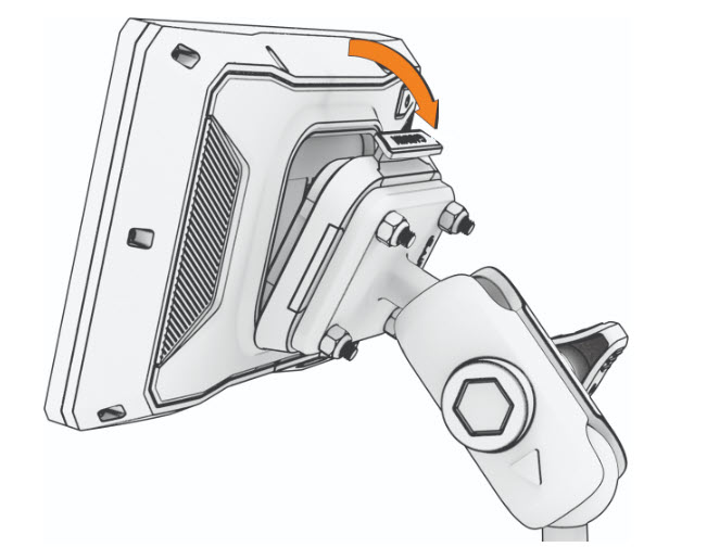

Installation of the Zumo XT2 mount:
Image of attaching the XT2 onto the motorcycle mount:
 Xt2 Mount image
