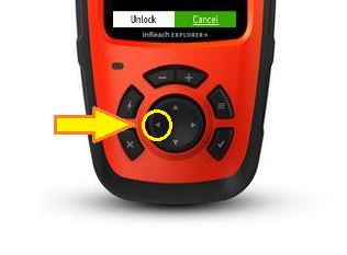

1. Hold down the power on your inReach handheld until the Turn On confirmation screen appears.
2. Press the Left Arrow on your inReach handheld to highlight Turn On in Green.

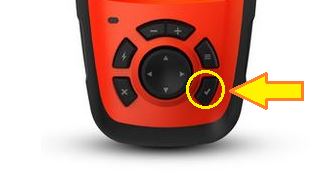

3. Press the Check Mark Button to turn on your inReach handheld. The device will load to the main menu.
