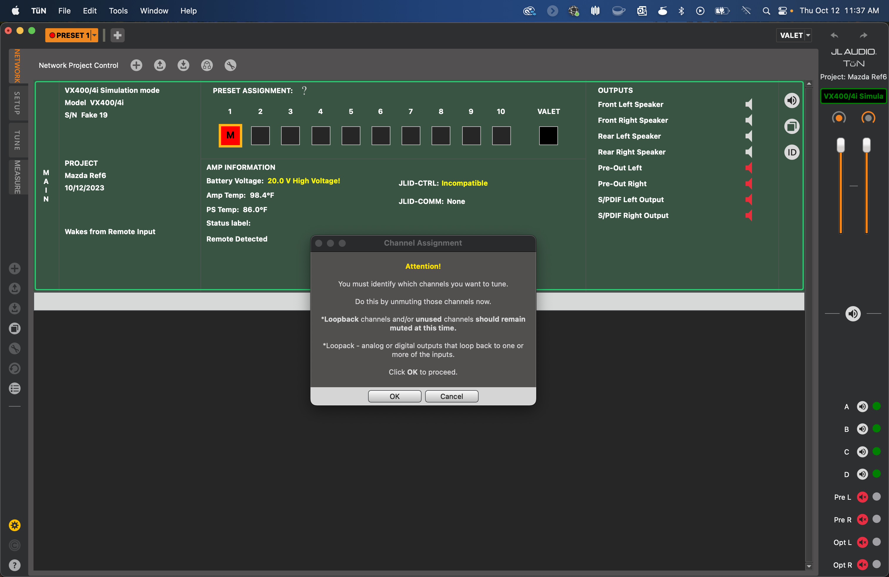

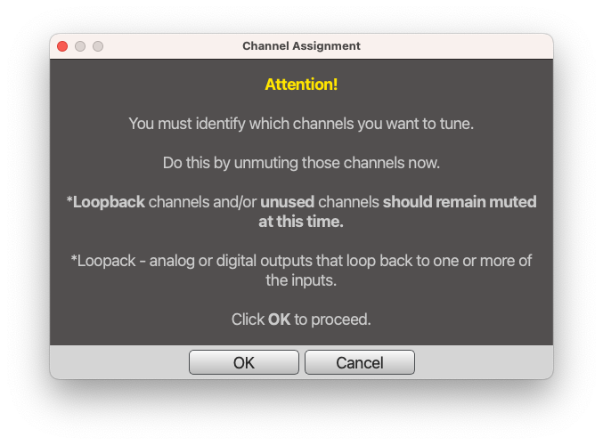

Expert Assist: Identifying Which Channels to Tune
Dialog Box informing the user to identify which channels they want to tune
Image shows Dialog Box informing the user to identify which channels they want to tune

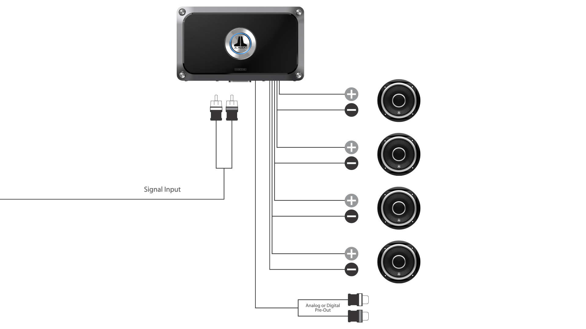

When using Expert Assist, a prompt will appear asking the user to identify which channels to tune. The user needs to select which channels to tune by unmuting those channels. This should be done on the Network Tab in TüN® Software. For example, below is a diagram with a four channel system. The channels that should be unmuted are channels A, B, C and D. All Pre-Outs should remain muted at this time. If the user is using a loopback for additional tuning capabilities, that should remain muted at this time as well.
VXi amplifier with four speakers connected
Image shows VXi amplifier with four speakers connected
network tab with four channels unmuted that need to be tuned
Image shows the network tab with four channels unmuted that need to be tuned

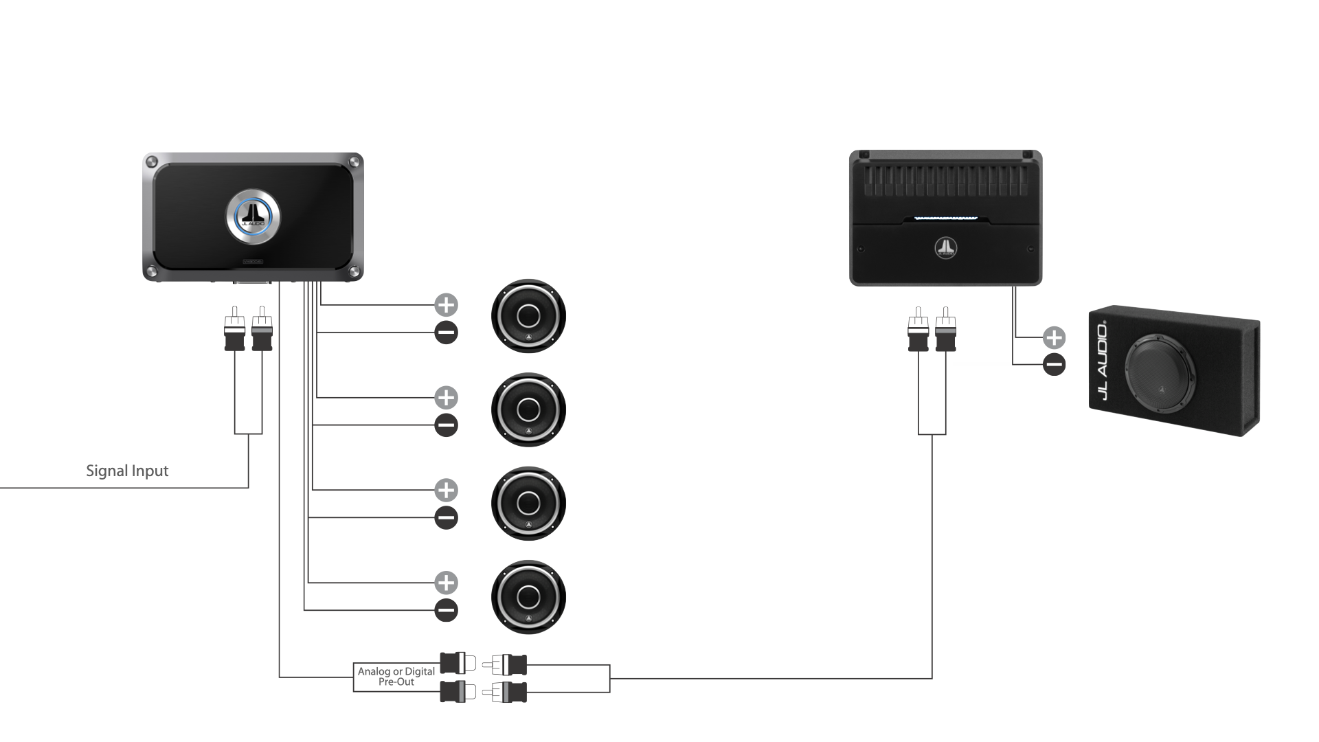

Here is another example. This is a two amp system, with the pre-outs from the VX amplifier feeding an RD amplifier without built in DSP.
VXi amplifier with four speakers connected and pre-outs feeding subwoofer amplifier
Image shows VXi amplifier with four speakers connected and pre-outs feeding subwoofer amplifier

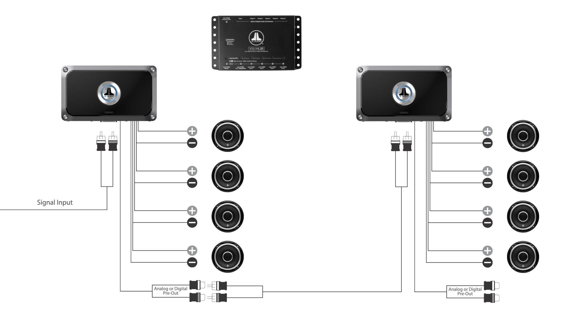

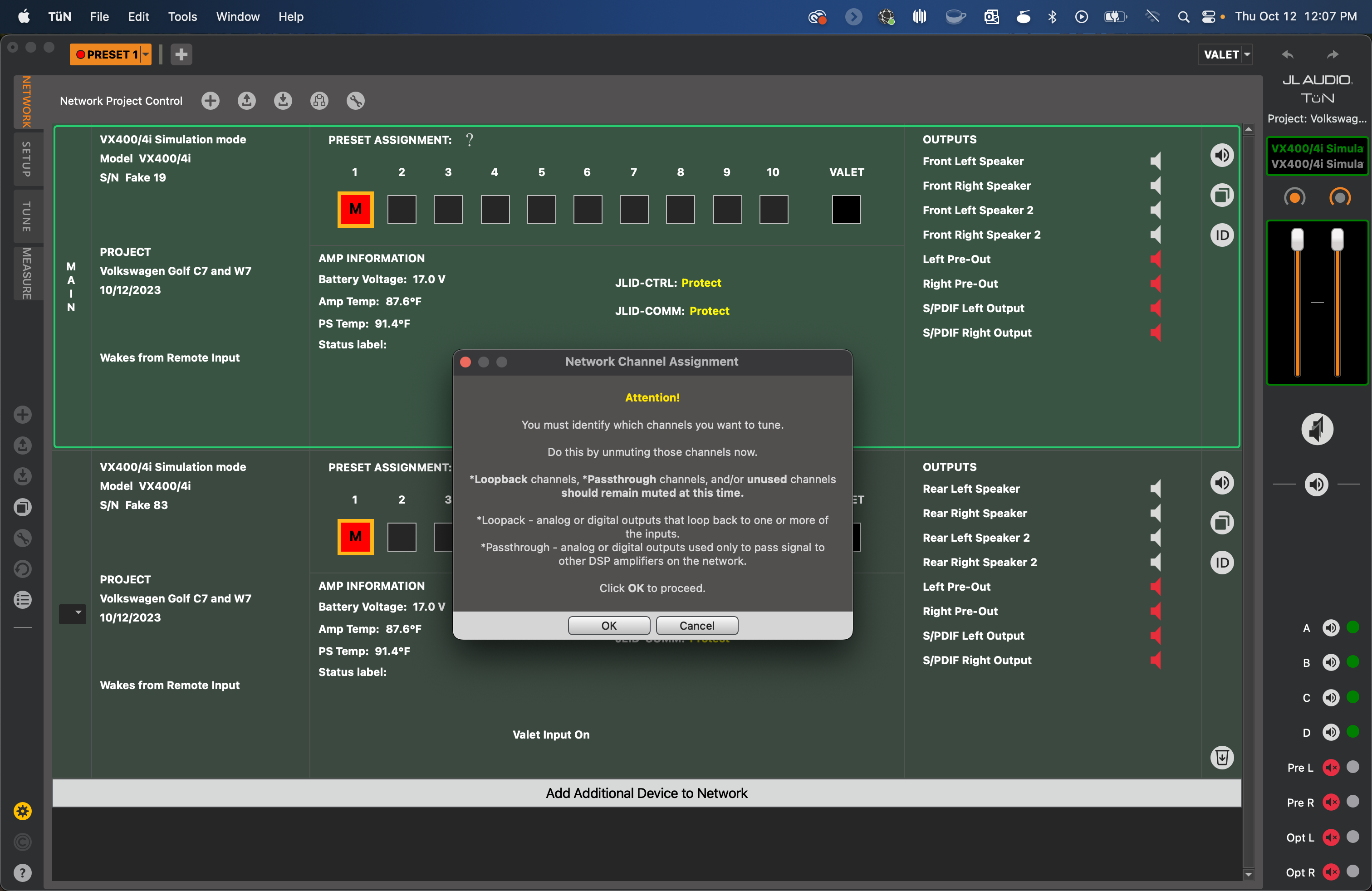

For a more complex system example, below is a networked system with two VX amplifiers on a network using a VXi-Hub. Both amplifiers are visible from the Network Tab in TüN® Software. Here, the user should identify which channels they want to tune across the entire network. So if all eight of the speakers are in the same area that needs to be tuned, they all eight channels should be selected. If they are split up between two areas, then only the speakers in the first area where the microphone(s) are should be selected. Expert Assist can be run succesivley for another area or zone.
two VXi amplifiers connected via a VXi-Hub
Image shows two VXi amplifiers connected via a VXi-Hub
network tab with the channels unmuted that need to be tuned
Image shows the network tab with the channels unmuted that need to be tuned
