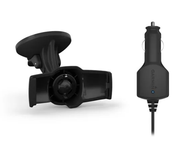

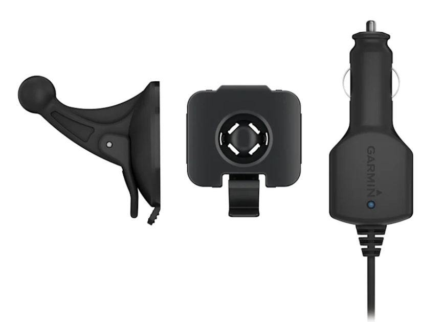

  • An automotive mount is used in a regular vehicle instead of a motorcycle, typically via suction cup, and receives power with a 12 volt Vehicle Power Cable. See example automotive mount kits below:

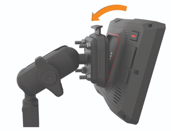

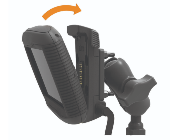

  • A motorcycle mount is used on a motorcycle, typically via the handle bars. The device receives power from a motorcycle power cable wired into the bike and connected through the mount. When the device is placed on the mount and powered on, it will charge. See example motorcycle mounts below:
