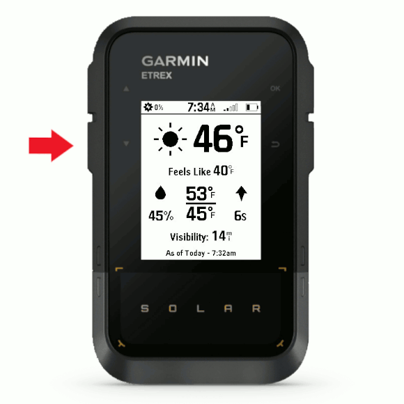

Select Weather from the main menu or the glance loop to view forecast details.
After selecting Weather, use the  Up button and Down Button buttons, or OK to view more forecast details.
