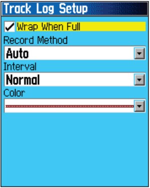

Track Setup
  1. Press Menu/Find twice to open the Main Menu page.
  2. Use the Thumbstick to highlight 'Tracks' and then press it in to select it.
  3. Use the Thumbstick to highlight and select 'On' or 'Off' to enable/disable track recording.
  4. Highlight 'Setup' and then press in on the the Thumbstick.
  5. You can check 'Wrap When Full' by highlighting it and then pressing in on the the Thumbstick.
    You can highlight the 'Record Method,' 'Interval,' and 'Color' fields and press in on the the Thumbstick to display their options. 'Interval' options change to accommodate the 'Record Method' choices.
    Track Log Setup Page
