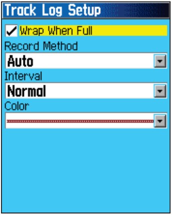

Track Setup
  1. Press QUIT until the Main Menu page appears.
  2. Use the THUMBSTICK to highlight 'Tracks' and then press it in to select it.
  3. Use the THUMBSTICK to highlight and select 'On' or 'Off' to enable/disable track recording.
  4. Highlight 'Setup' and then press in on the the THUMB STICK.
  5. You can check 'Wrap When Full' by highlighting it and then pressing in on the the THUMB STICK.
    You can highlight the 'Record Method,' 'Interval,' and 'Color' fields and press in on the the THUMB STICK to display their options. 'Interval' options change to accommodate the 'Record Method' choices.
    Track Log Setup Page

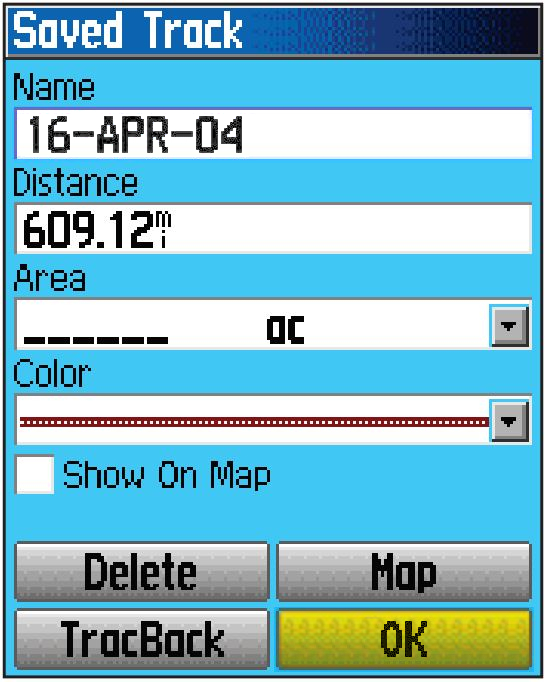

Saving the Current Track Log
  3. Use the THUMBSTICK to highlight 'Save' and then press it in to select it. Select 'Yes' or 'No' when prompted with 'Do You Want To Save the Entire Track?'
    • If you select 'Yes,' a 'Saving Track' message appears followed by the Saved Track Page. The new saved track is a representation of the entire track log from beginning to end.
    • If you select 'No,' a map showing the entire track appears. Follow the prompts to select the beginning and ending points for the track by using the THUMBSTICK to move the panning arrow and select the desired points on the map.
  4. A 'Saving Track' message appears followed by the Saved Track page. Use the THUMBSTICK to highlight and select 'OK' to save the track.
    Saved Track Page With OK Highlighted
The track is now saved in the 'Saved Tracks' list on the Tracks page.

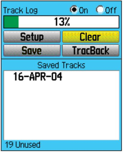

Clearing the Track Log
  3. Use the THUMBSTICK to highlight 'Clear' and then press it in to select it.
    Tracks Page With Clear Highlighted
  4. Use the THUMBSTICK to highlight 'Yes' and then press it in to select it.
