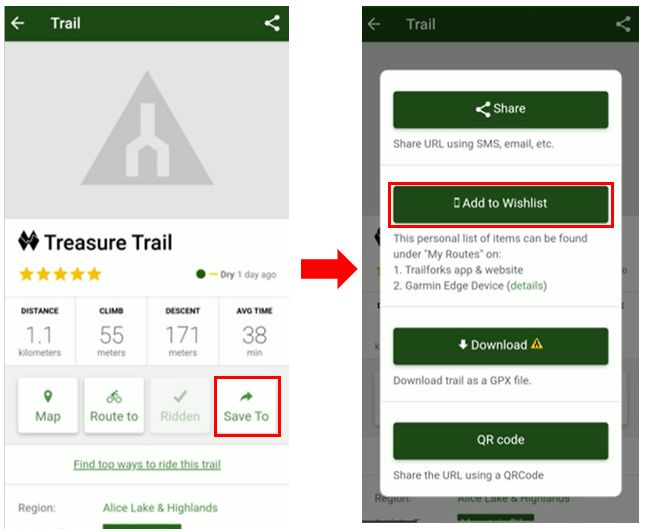

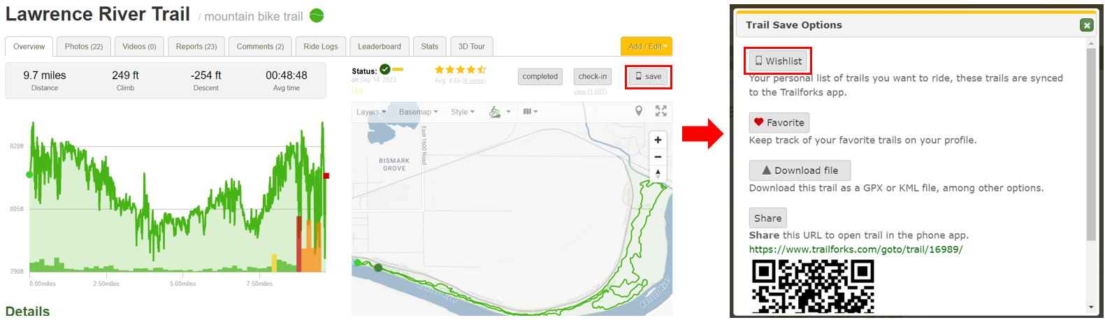

Step 3: Select and Save Routes to Your Garmin Device
Routes can be saved by adding them to your "Wishlist" on Trailforks.com or through the Trailforks mobile app on your smartphone. After you sync your Garmin device, routes saved to your "Wishlist" in Trailforks will appear under "My Routes" on the Trailforks Connect IQ app on your Garmin device.
Trailforks App
screenshots of saving trail to Trailforks wishlist
Trailforks Website
screenshots to add to wishlist on trailforks web version
