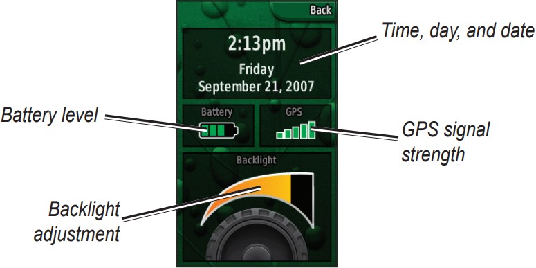

  1. Press and quickly release the Power key. The System Status page on the Colorado appears
  2. Rotate the Rock ‘n Roller clockwise or counter-clockwise to increase or decrease the backlight.
  3. Select Back to close the System Status page and return to the previous page
Backlight Screen
NOTE: The System Status page is also a quick way to check the time, day, date, battery level, and GPS signal strength.
