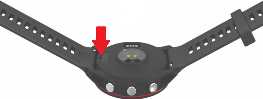

Clean the Sensor Port on the Watch
A blocked or clogged sensor port can lead to:
  • Wrong elevation or barometer readings
  • Incorrect Floors Climbed credit
To clean the sensor, locate the port on the back of the watch (it will be a small hole at the 6 o'clock position). You can rinse the port with water or you can also soak the watch in water for 5 minutes, agitating it every minute to help breakdown and remove any debris, such as sweat crystals or skin cells. After cleaning and/or soaking, allow the watch to dry completely.
IMPORTANT: Do not insert anything into openings on the watch (including canned air) as this can damage the internal sensor.
