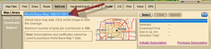

  4. Select the World Base Map 7 data.
  5. Click the Select  button.
  6. You will receive the notice below.  Choose Click Here to download option.

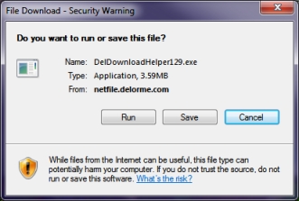

  7. Click Run on the File Download window.
    Note: If prompted, choose to allow the file to run.

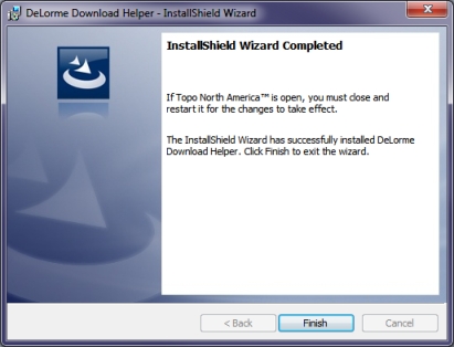

  8. Click Finish when completed

  3. Click Run on the File Download window.
  4. Click Finish when completed.
  5. World Base Map 7 should now be visible within Topo North America.
