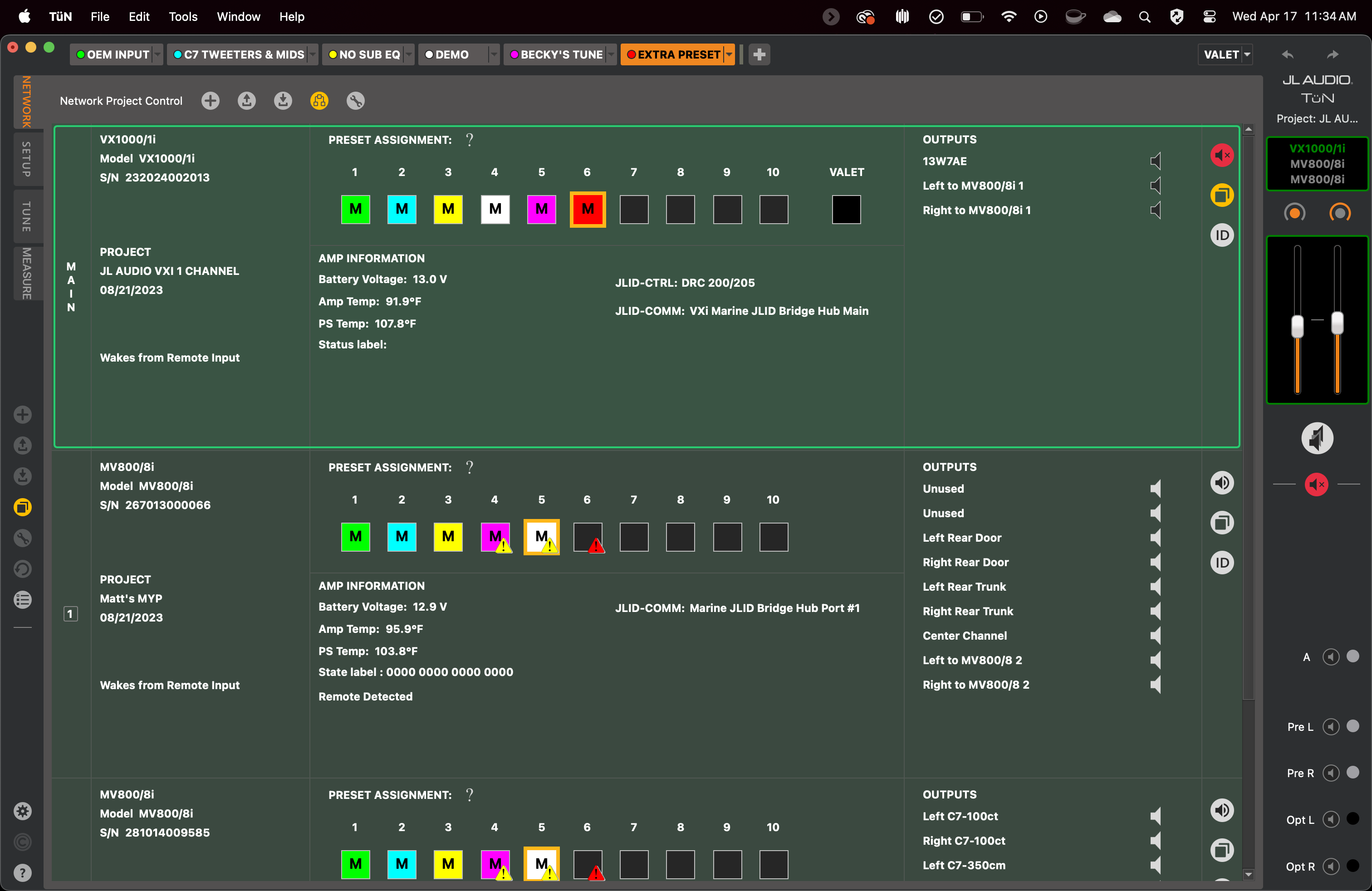

If any of the active presets are out of order on any device, or if there are mismatched colors, this can cause issues and will be highlighted within the Network Tab in TüN® with a yellow warning triangle ️Yellow Warning Button . If there are any active presets missing on any device, it will flag the other devices with a red warning triangle Red Warning Button. If there are any non-active presets that are missing from any devices, a yellow warning triangle Yellow Warning Button️ will be displayed, however since it is not an active preset the device will still function normally.
Figure A displays a three amp network with mismatched presets
