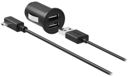

Dual USB Power Adapter with Included Cable
Power your compatible Garmin Dash Cam with this adapter while also having the ability to charge a phone, tablet or any other device needing power while on the go.
Garmin Dash Cam™ X110 | Garmin Dash Cam™ X210 |Garmin Dash Cam™ X310 | Garmin Dash Cam™ Mini 3 driving recorders:
Includes the dual USB power adapter and a 13-ft long (4 meters) USB-C power cable for hidden installations.
  • The 13 ft. (4m) cable is meant to route either up or down from the camera as seen in the owner's manual.
    • The power cable included with your device is intended for power only.  It cannot be used to transfer data to/from your computer or update with Garmin Express.
    • Data transfer cable options (purchased separately) include USB Cable Type A to Type C and USB Cable Type C to Type C, depending on the type of ports available on your computer.
    • For other power and data cable options, choose your dash cam model, then select the Accessories tab.
  • For replacement options, see Vehicle Power Kit.

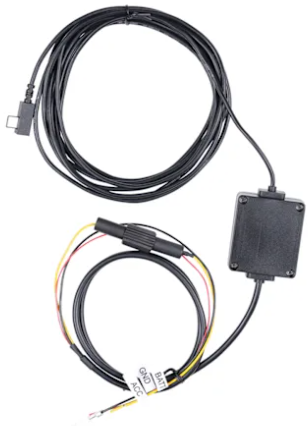

Parking Mode Cable
  • Connect your compatible Garmin Dash Cam to constant power from the vehicle's fuse box.
  • The cable is 4 meters long.
  • Professional installation by an experienced installer is recommended.

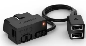

Constant Power Cable
  • Cable will plug into your vehicle’s OBD-II port for constant power to your compatible Garmin Dash Cam, even when the vehicle is parked and turned off.
  • Cable is compatible with most passenger vehicles.
  • Cable is not compatible with a J1939 connector.
  • Time switch for 10 minutes, 24 hours, and always on.
  • Will protect the battery by shutting down after 10 minutes if it detects the battery is low (less than 12V).
