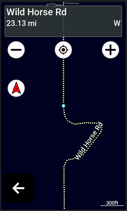

  1. During the ride on the map data screen:
    • With touchscreen: Select White carat icon on black background with white semicircle above (tray icon) by swiping up from the bottom of the screen.
    • With buttons: Press the top right button > Select Map Overlays.
  2. Select Unpaved Roads.
Below is an example of how a gravel road will appear on the map screen with Unpaved Roads enabled in the map details:
Edge 1050 map screen with a dotted line showing a gravel road ahead

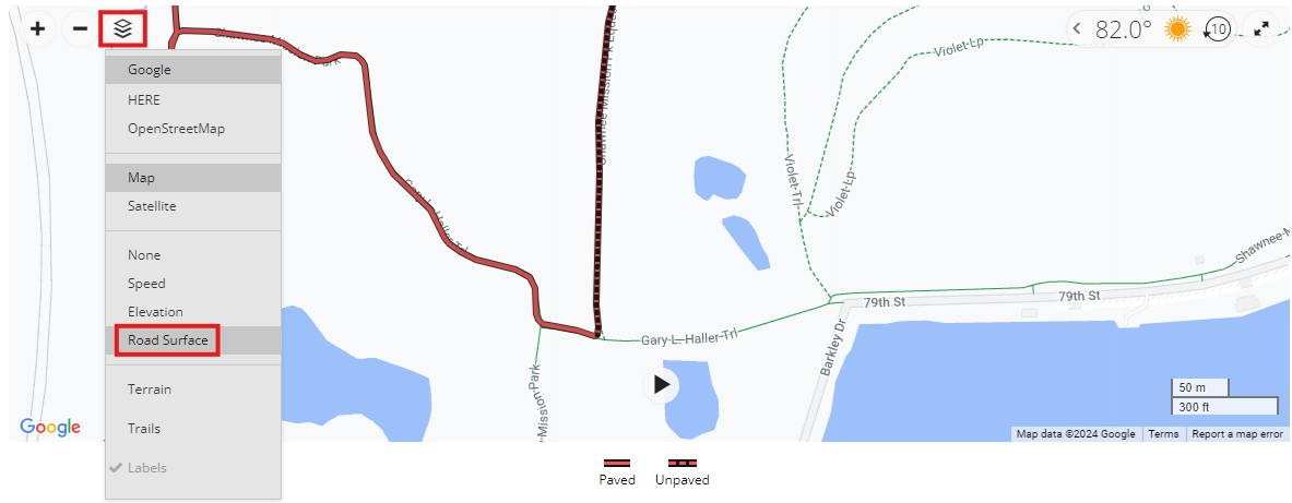

GPS Overlay
  1. In the GPS map of the activity summary, select Two squares stacked on top of each other (Connect App) or Three squares stacked on top of each other (Connect Web).
  2. Select Road Surface.
 Garmin Connect web map of ride with solid line for paved and dotted line for unpaved
Surface Percent
In the Stats section of the ride summary, you will be able to view the share of the ride that was paved vs. unpaved.
