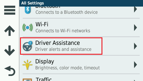

      1. On the zumo 396, select Settings
      2. Select Driver Assistance

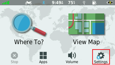

1. Touch Settings
zumo 396 Settings
2. Touch the down arrow on the left, then touch Driver Assistance
zumo 396 Driver Assistance

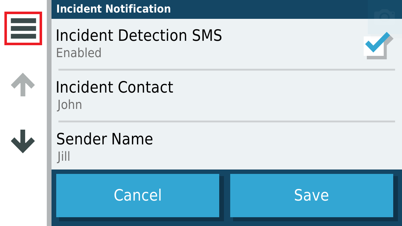

3. Touch the down arrow, then touch Incident Notification
4. Touch Continue
  • If prompted, first allow permissions to allow phone contacts to be synced for usage with the incident notification feature.

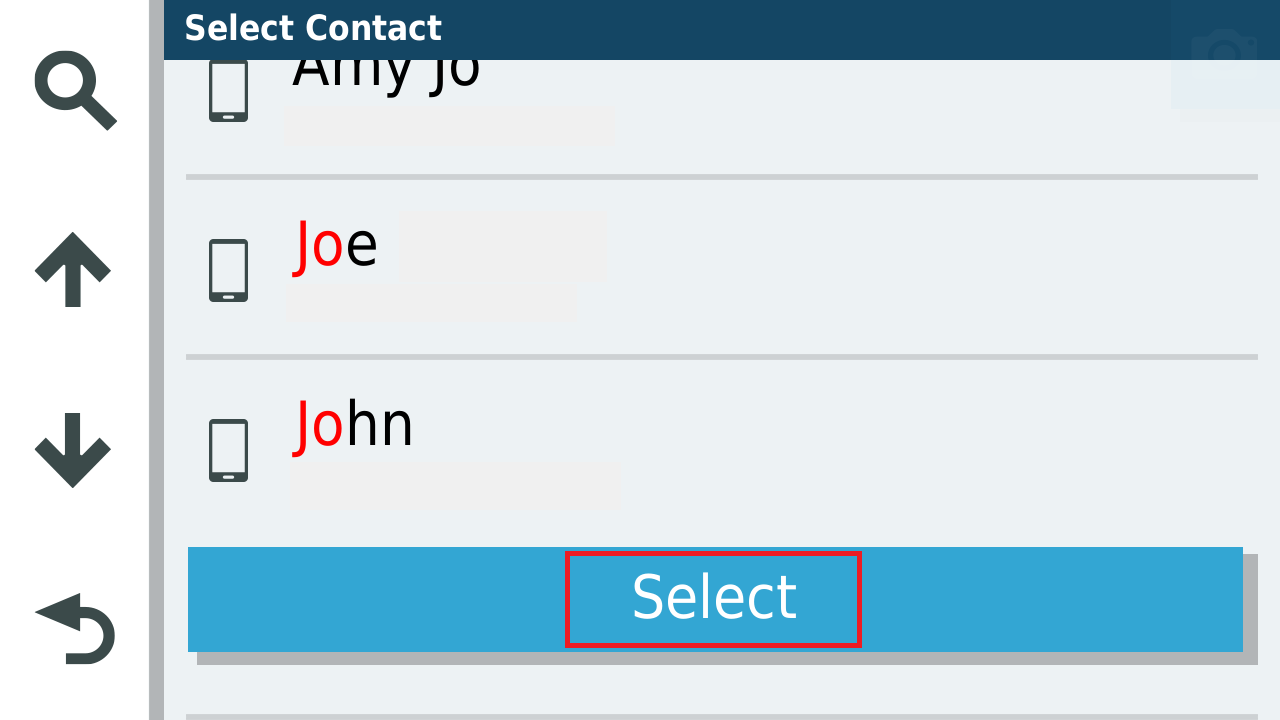

5. If the desired contact is listed, select it and skip to step 7.
  • If the contact is not listed, touch the magnifying glass in the upper left corner.

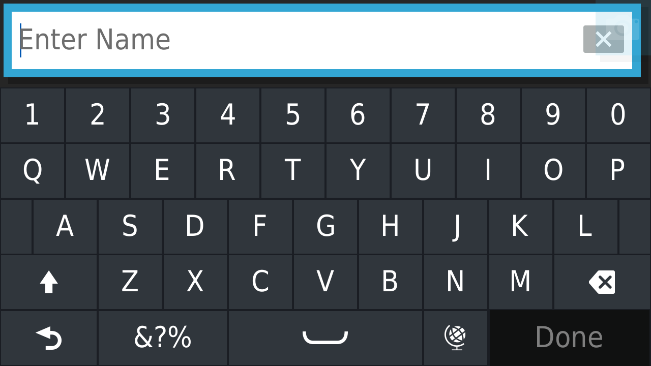

6. Type the contact name

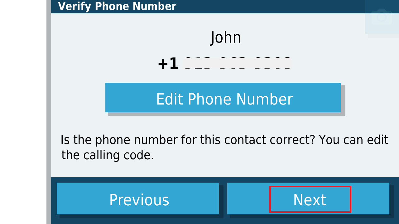

7. Touch the contact name, then touch Select
8. Touch Next

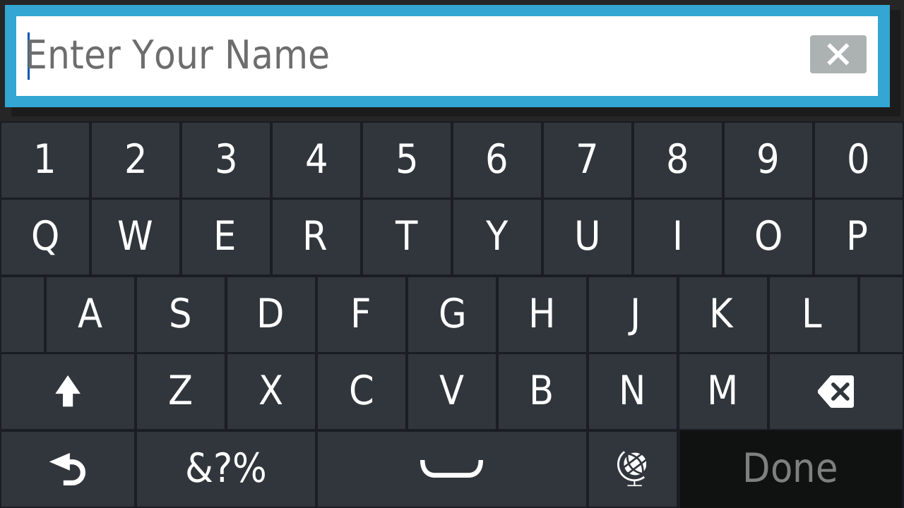

9. Type Your Name
10. Touch Next

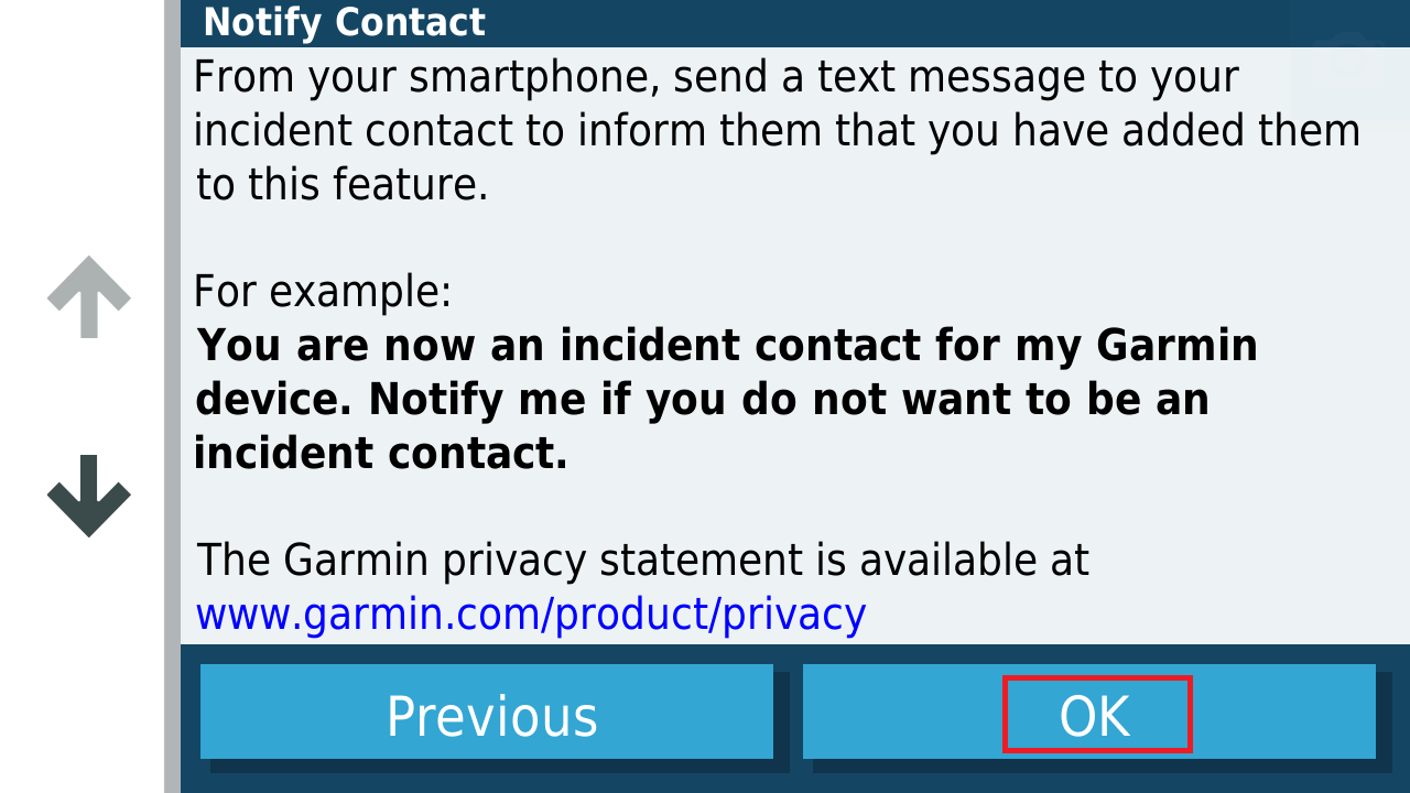

11. Touch OK
  • A text or email will be sent to your selected emergency contact (see example below)
  • The contact will now be notified in the event of an incident.
  • To remove a contact see the steps below, 'Removing Emergency Contacts'
12. Touch Save

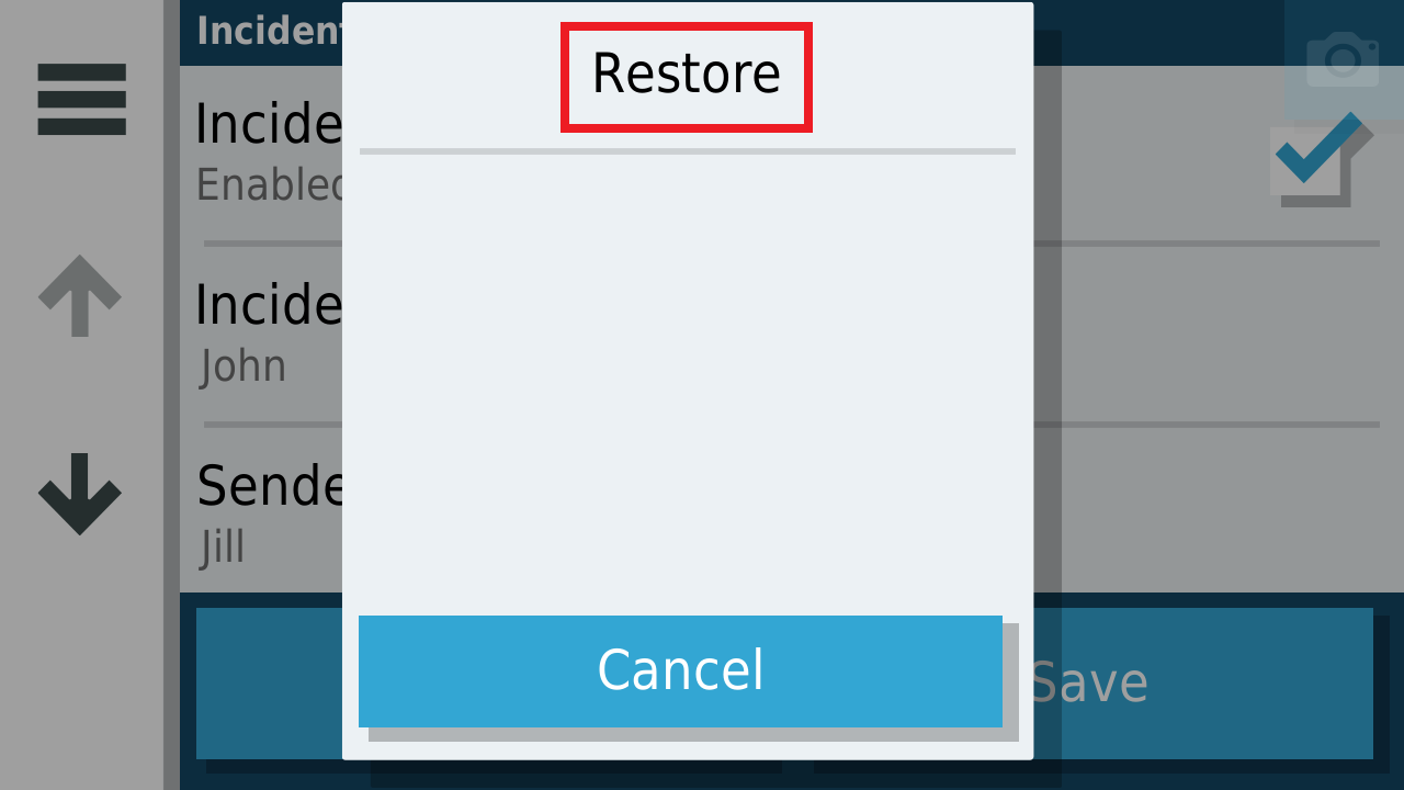

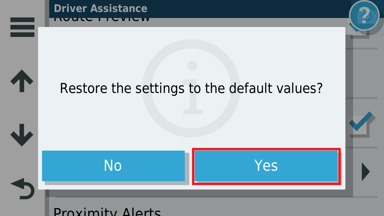

1. Touch the menu in the upper left
Restore Menu.
2. Touch Restore
Restore 1
3. Touch Yes
Restore Yes
The saved contact will now be deleted.
