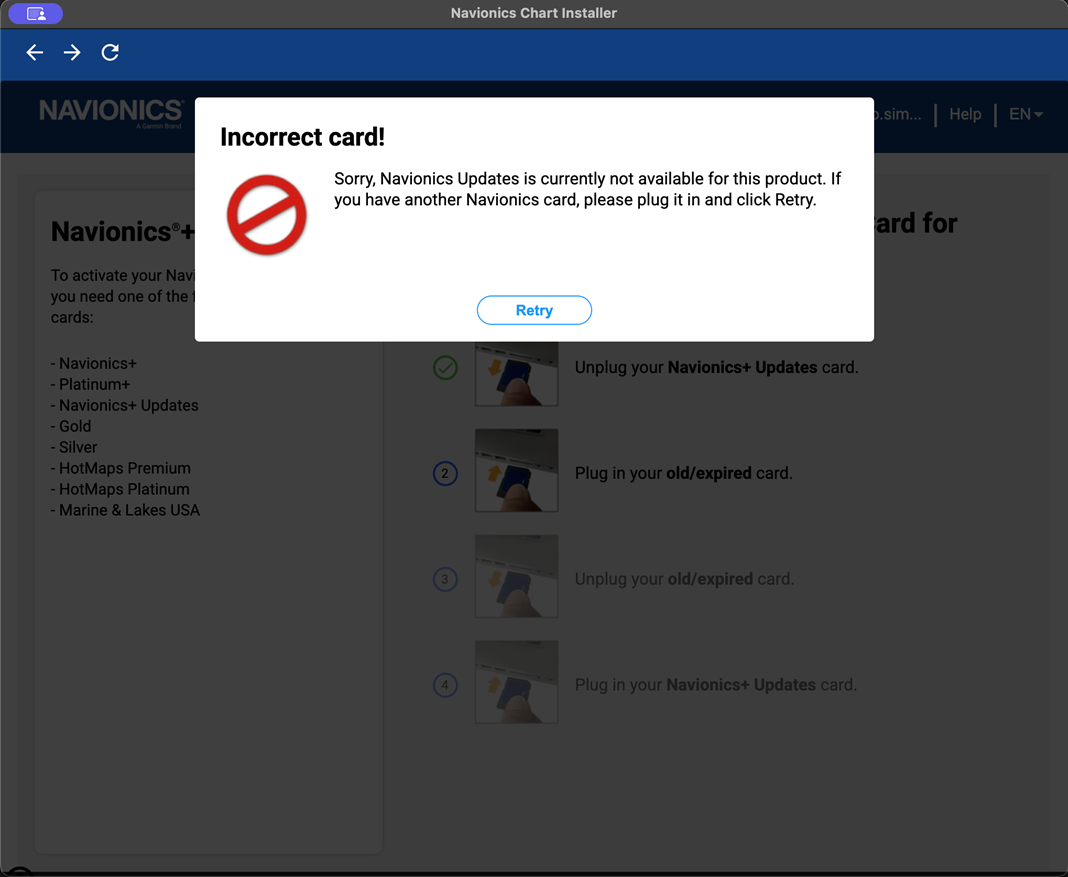

Once you have successfully downloaded the Chart Installer, plug your new Navionics+ Updates card into your computer and follow the prompts on the screen.
  1. Remove your new Navionics+ Updates card from your computer.
  2. Plug in your eligible card.
  3. Remove the card inserted in step 2.
  4. Plug your new Navionics+ Updates card back into your computer.
You will receive a message your marine chart subscription is now active.

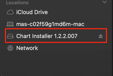

NOTE for MAC Users:
Chart Installer update volume showing in Finder.
If you receive the message "Sorry. Navionics Updates is currently not available for this product" when using a MAC computer, and the old/expired card is an eligible card, eject the Chart Installer volume using the Eject button in Finder. Then try refreshing the Chart Installer using the refresh button (circular arrow) in the upper-left of the screen.
