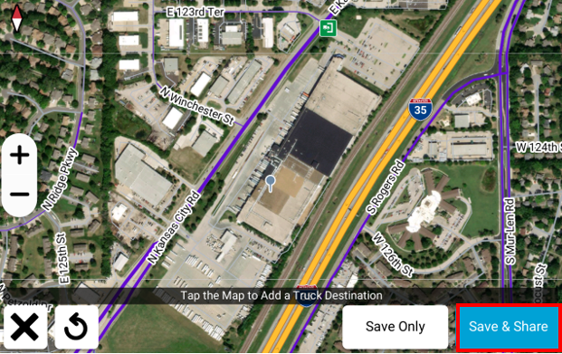

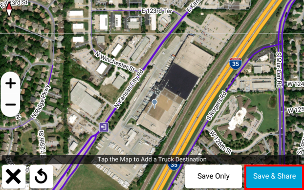

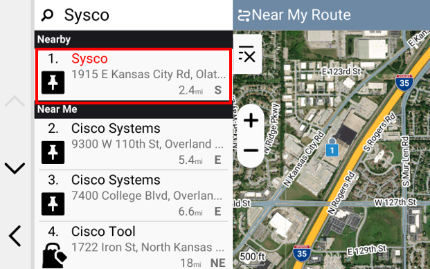

Sharing dēzl Community Truck Destinations

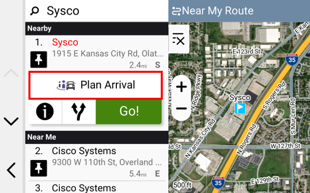

1. Select Where To?
2. Use the search options to find a location
3. Select a location
4. Select Plan Arrival
5. Select the location on the map you want to save
  • Select Add Destinations first if other locations have been set for this address already

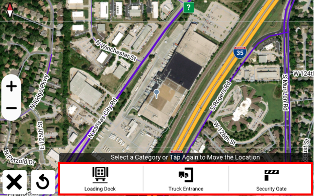

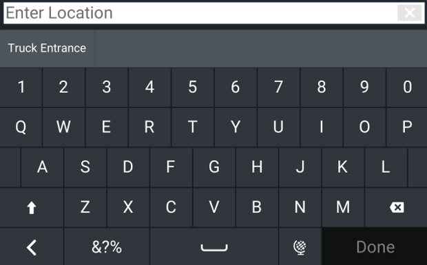

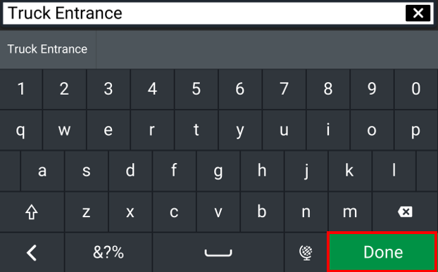

6. Select the location category
7. Enter the location name
8. Select Done
9. Select Save & Share to save the location for both yourself and other drivers using this feature
  • Select Save Only to save the location locally on your device without sharing it to drivers

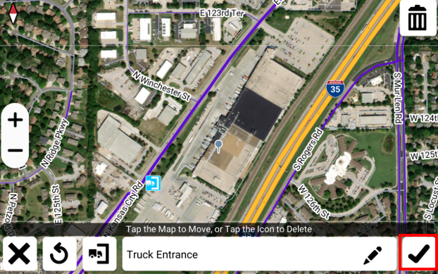

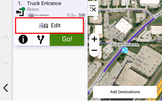

Editing dēzl Community Shared Truck Destinations
NOTE: These edits will apply to your device only.
1. Select Where To?

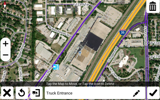

5. Select Edit
6. Options available to edit.

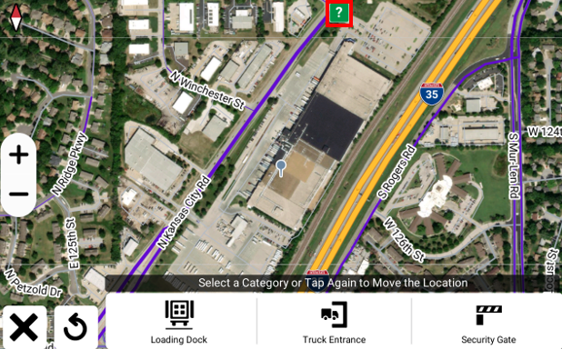

  • Select the icon if the location does not exist or is the wrong business
  • Select the icons to change the category to a loading dock, security gate, or truck entrance
  • Select the pen icon to rename the category
  • Select the curved arrow to undo any changes
  • Select the 2024 dezl X icon to exit out
  • Select the to zoom in on the map
  • Press the  to zoom out on the map
  • Tap another location on the screen to move the location of the loading dock, security gate, or truck entrance
7. Select the Checkmark
8. Select Save & Share to share the location to the dezl community
  • Select Save to save the location locally on your device without sharing it to drivers

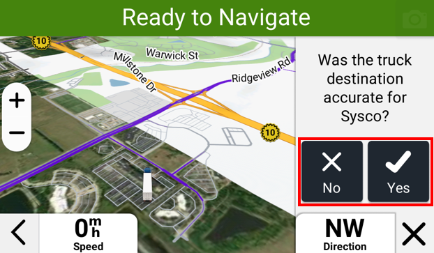

Navigating to and Confirming a dēzl Community Location is Accurate
1. Select Where To?
5. Select Go!
6. When you arrive at the destination you will receive a prompt asking if the truck entrance was accurate. Select Yes or No.
7. If no was chosen, select what's wrong with the location
8. The prompt "Thank you for your feedback!" will appear.

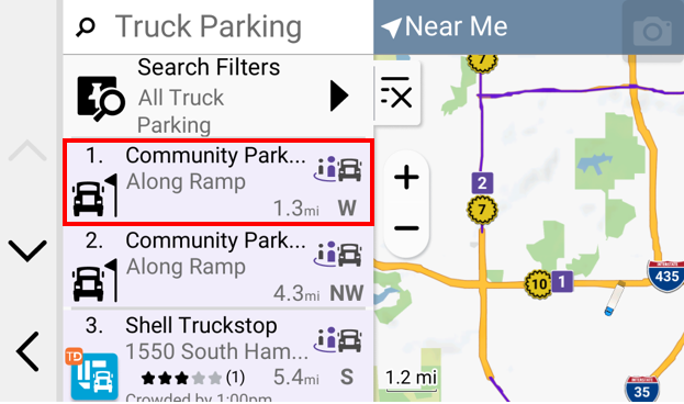

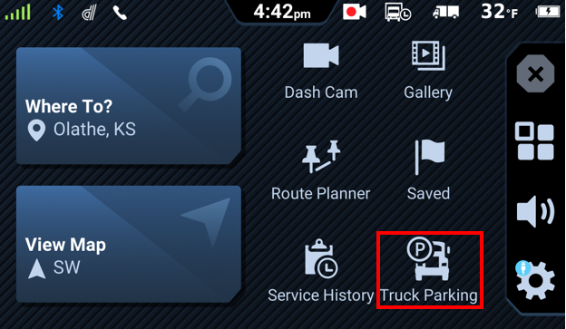

dēzl Community Truck Parking Ratings
1. Select Truck Parking
2. Select the Destination
3. Select Go!
4. When you arrive at the destination, rate the parking availability
5. Report the total truck parking spots available
6. Select Next
7. Select 1-5 stars to rate the parking location
8. Select a thumbs up or thumbs down under How is this location? (Select all that apply)
9. Select Send

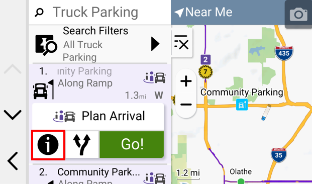

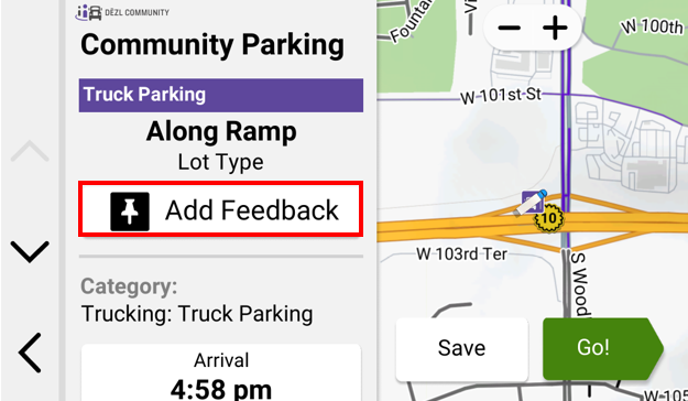

If the truck parking isn't rated when you arrive, it can done at a later time by following the steps below.
1. Touch Truck Parking
2. Touch the truck parking destination you recently visited
3. Touch the information button
4. Touch Add Feedback
