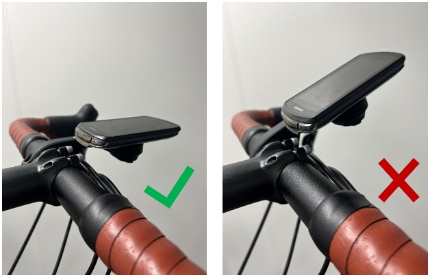

Mounting Position
To get the most out of the sun's power, the solar lens should have the maximum exposure to the sky. The position of the mount can impact the angle in which the Edge receives its light. Your riding position can also block light more if the Edge is mounted to face you. Consider where you have the Edge mounted and the direction of the sun.
Edge 1040 in tilted and flat positions

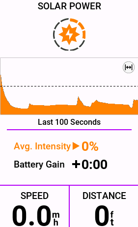

Solar Power Screen Examples
In Partial Sun
screenshot of Edge Solar Data screen in partial sun
In Full Sun
Edge solar gain in full sun
The Battery Gain in this example represents 7 minutes and 48 seconds.
