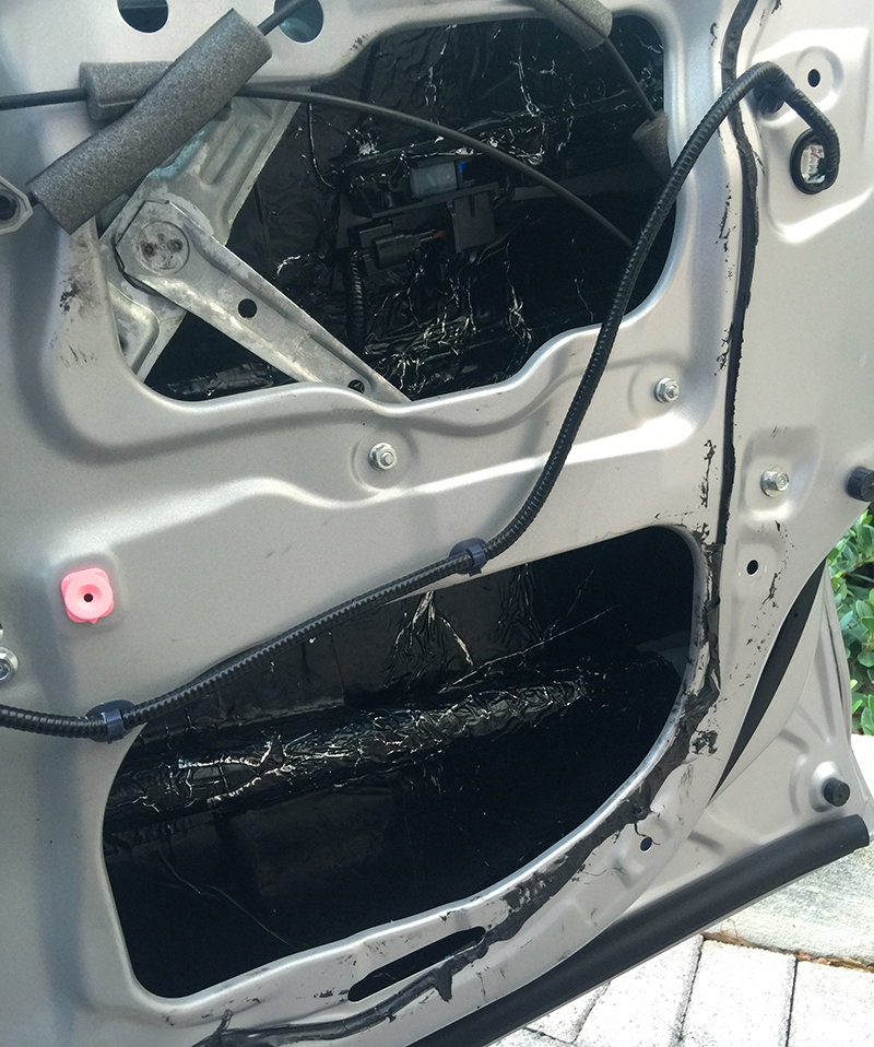

1. Deaden the outer sheet metal of the doors:
Sound DeadeningUse a high quality sound deadening (damping) material and place it inside the outer sheet metal layer of each door or quarter panel. Usually it is easier to cut the mat into strips so that it can be easily slipped through the stamped holes on the inner sheet metal. First prep the area with window cleaner or isopropyl alcohol so that the material adheres properly and then place it from top to bottom on the inside of the outer sheet metal. There are many companies that offer quality damping materials. Among the more popular brands are Hushmat and Dynamat, but there are many others.
2. Seal up the inner sheet metal of the doors:
Use a thin but ridged material such as aluminum sheeting, plastic sheeting or Masonite™ (thin press board) to make cover plates that will plug all the holes that are stamped into the inner sheet metal of each door or quarter panel. Use either foam tape or silicon along with stainless steel self-tapping screws to hold the plates in place securely. If the opening is to be used as an access panel for internal mechanisms, make sure you can remove them without too much effort.
3. Deaden the inner sheet metal of the doors:
This is similar to Step 1, except now use one large sheet of sound deadening material and cover the entire inner sheet metal and the cover plates that were installed in Step 2.

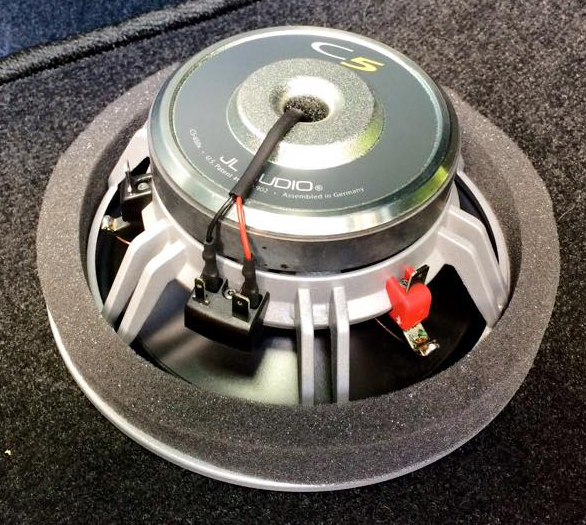

5. Gasket each speaker:
This last step is to use foam tape around the flange of the speaker before installing it. This will ensure a good seal between the speaker and door panel.
C5-650x Back

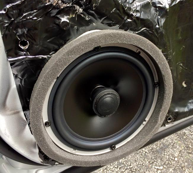

6. Decouple the speaker from your vehicle:
To ensure that all of your speaker's energy is forced into the cabin of your vehicle and not lost inside the door panel use a foam ring around the front of the speaker after it's mounted to the door.  This foam should firmly make contact with the door panel.  This will also help prevent unwanted vibrations in the door panel.  You can make your own ring using a thick foam tape or find specialty products for this application.
