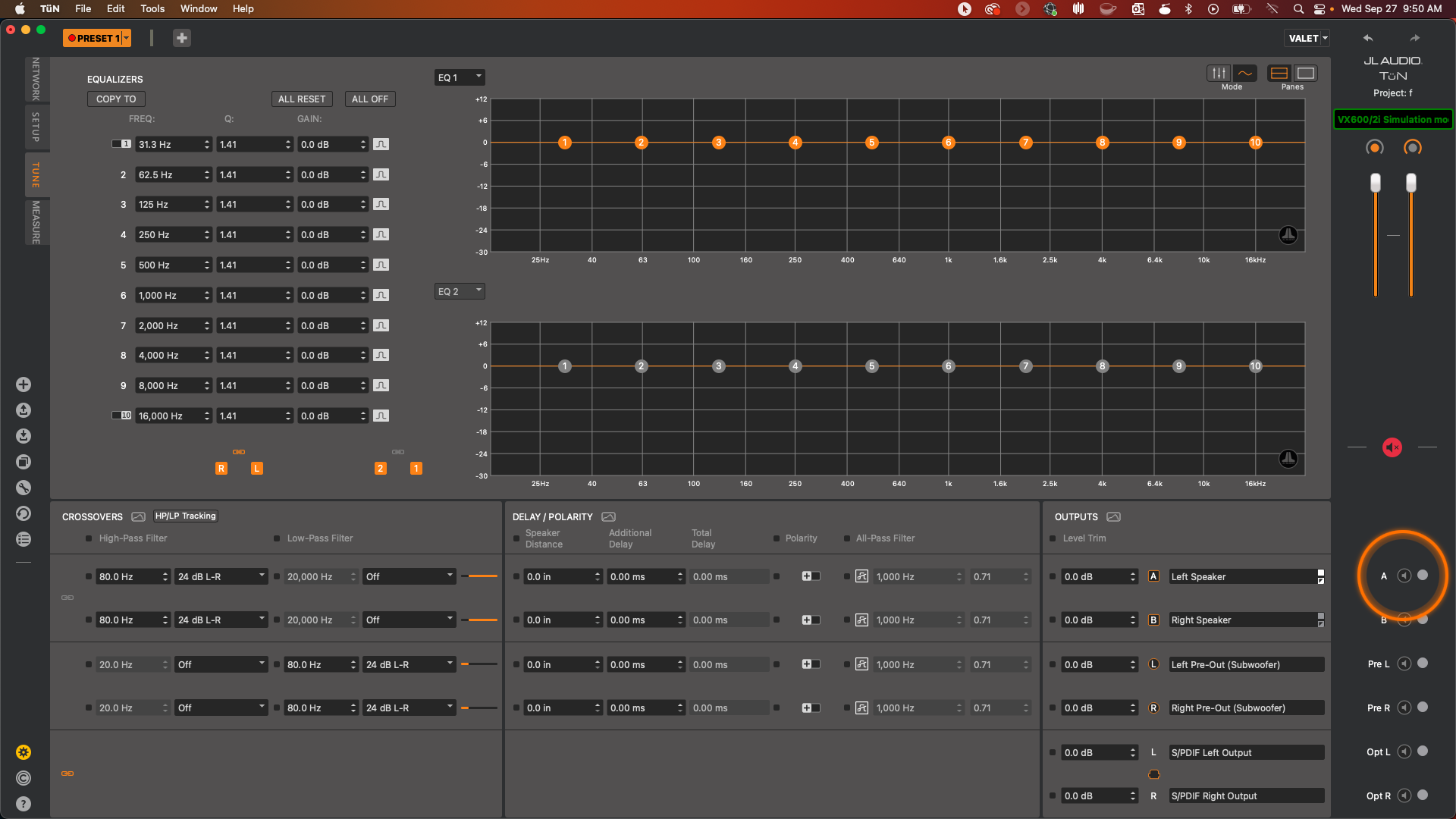

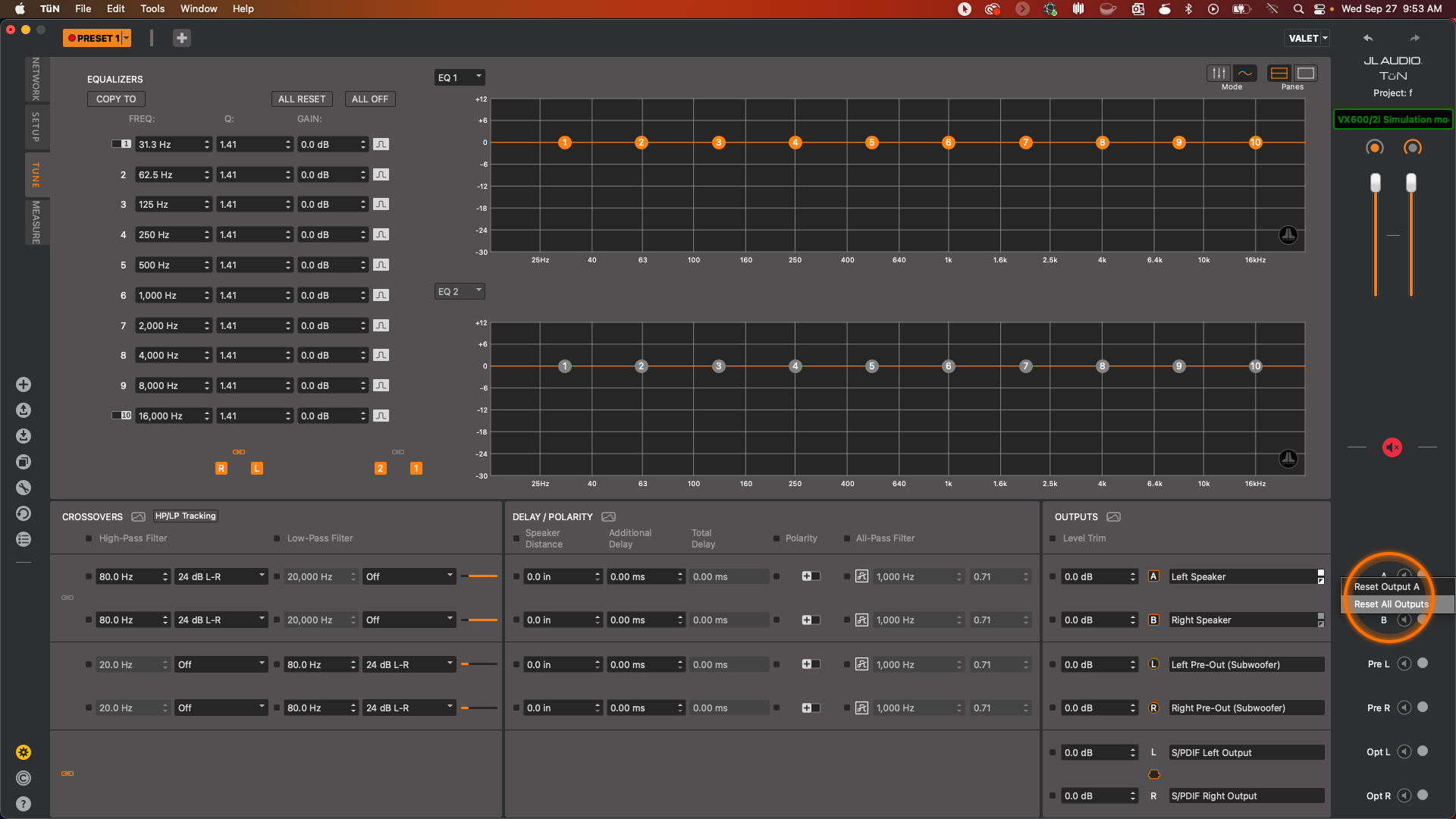

When using any JL Audio system tuning DSP, the output channels can be reset very easily. In TüN® Software, when connected to a DSP product or in simulation mode, the mute controls can be found in the lower right corner of the interface. The user can right click on any of the individual mute icons to reveal a reset option. The user can choose to either reset only that channel or reset all channels. Resetting all channels will only apply to the active preset and the selected device. If there are multiple devices, the user can repeat the process on those devices.
Individual output mute for channel A
Right Click on Channel A reveals this menu
