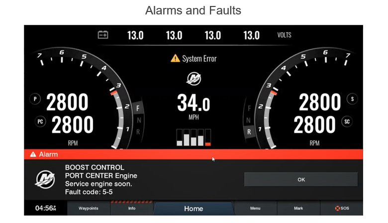

A GPSMAP® chartplotter will display an alarm message as seen in the example below
              Alarm Message on GPSMAP display
  • The message will populate the bottom of the GPSMAP display
  • The message will be color coded Red, Yellow, or Blue to prioritize the alarm severity
    • Red: Hazards that require immediate action to avoid sever personal injury or death
    • Yellow: Hazards or unsafe practices which could result in minor personal injury or product or property damage
    • Blue: Unspecified or informational condition, take appropriate action
