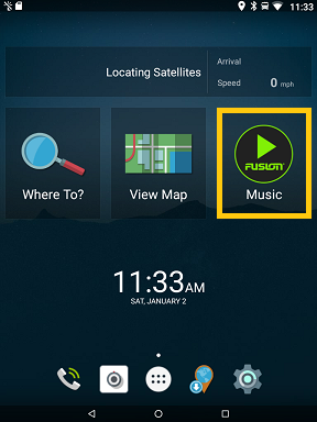

  1. From the Home screen, select Music
    select music

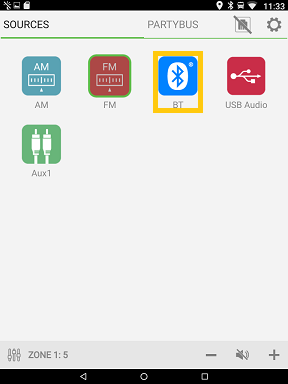

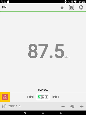

  2. Select the Source icon near the bottom left corner of the screen
    select source
  3. Select BT
    select BT

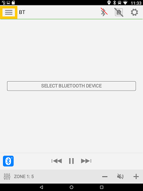

  4. Select Menu near the top left corner of the screen
    select menu

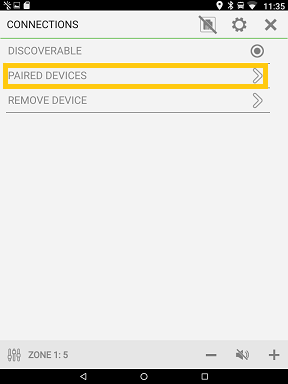

  5. Select Connections
    select bluetooth connections

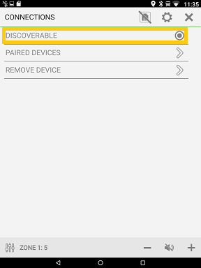

  6. Select Discoverable to turn it on
    turn on discoverable
    • Discoverable will automatically turn off after 2 minutes
    select music
    select source
  3. Select BT
    select BT
    select menu

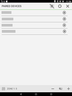

  6. Select Paired Devices
    select paired devices
  7. Select the Bluetooth device from the list of paired devices
    select a paired device
