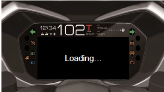

3. Open the Motorize app on your phone.
4. Long press the Home button on handle switch to enable projection.

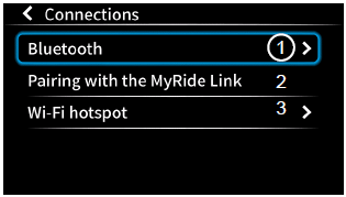

1. Pairing Motorcycle with Smartphone

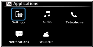

1. Select Applications
2. Select Settings

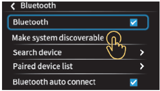

3. Select Connections, then Bluetooth

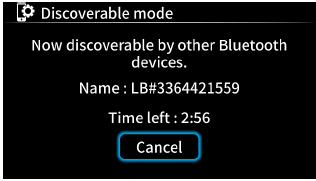

4. Select Make system discoverable

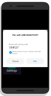

5. You can then pair your smartphone and your bike through your smartphone's Bluetooth settings page

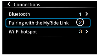

2. Connecting MyRide Link App
2. Select Settings
4. Select Pairing with the MyRide Link

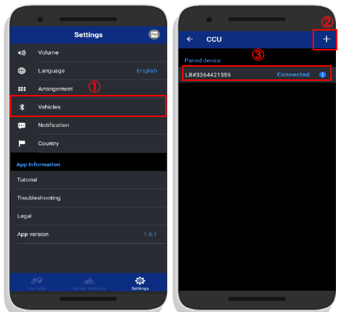

5. Go to the MyRide Link app on your smartphone and select Settings.
6. Select Vehicles
7. Select the Plus icon
8. Choose the device name on the smartphone
9. Check Connected status shows on the MyRide Link app

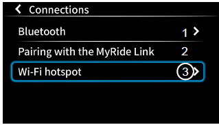

 3. Enabling Wi-Fi Projection
1. Ensure both Bluetooth and MyRide Link are connected
2. Select Applications
3. Select Settings
4. Select Connections

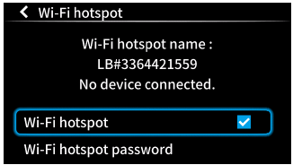

5. Select Wi-Fi hotspot
6. Ensure Wi-Fi hotspot is enabled

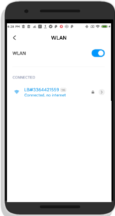

7. On your smartphone, connect to hotspot using the smartphone's Wi-Fi settings page
8. Ensure the network shows Connected, no internet on smartphone

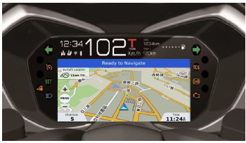

9. Open the Motorize App on your smartphone
10. Long press the Home button on the handle switch to enable projection
