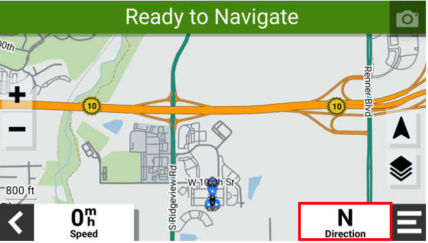

To Change the Trip Data Field:

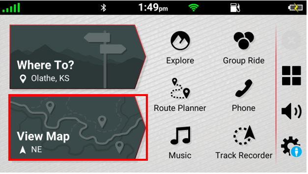

1. Touch View Map
2. Touch the data field that does not display Speed
3. Touch "+" next to the desired option to save the change
This selected data will now be displayed in the data field while driving.

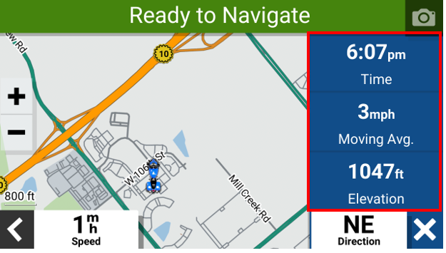

It is possible to add 3 additional data fields on the map by enabling the Trip Data map tool on the device.
To Enable Trip Data:
1. Touch View Map

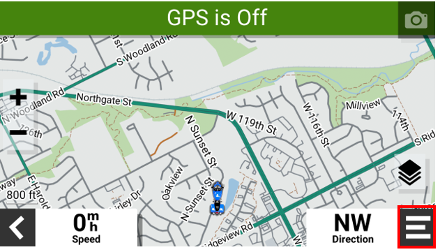

2. Touch the menu bar in the lower right hand corner

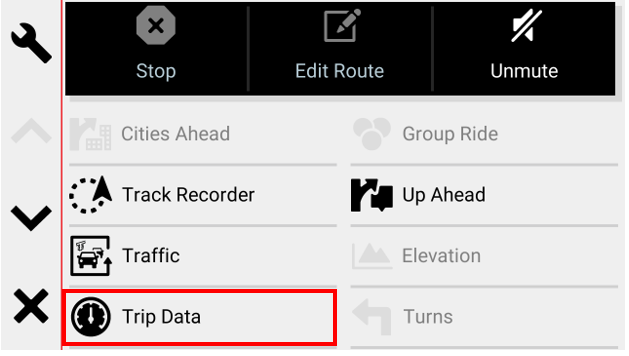

3. Touch Trip Data
Three additional data fields will appear on the right side of the screen. You can customize these by touching any one of them, then touching the + icon next to the desired data type, which will automatically change the type of data displayed.
