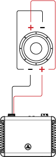

One DVC driver with Voice Coils in Series
Picture Wiring One DVC driver with Voice Coils in Series
One Dual Voice Coil Speaker in Series
Connecting the two voice coils of the driver in series (+ to -) will result in the following impedances:
  • Dual–8 Ohm Subwoofer: 16 Ohms
  • Dual-6 Ohm Subwoofer: 12 Ohms
  • Dual–4 Ohm Subwoofer: 8 Ohms
  • Dual–2 Ohm Subwoofer: 4 Ohms
  • Dual–1.5 Ohm Subwoofer: 3 Ohms

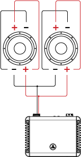

Two DVC drivers with Voice Coils in Parallel / Parallel
Photo Wiring Two DVC drivers in Par_Par
Two Dual Voice Coil Speakers in Parallel / Parallel
Connecting the voice coils of each driver in parallel (+ to +, - to -) and the drivers themselves in parallel (+ to +, etc.) will result in the following impedances:
  • Dual–8 Ohm Subwoofers: 2 Ohms
  • Dual-6 Ohm Subwoofers: 1.5 Ohms
  • Dual–4 Ohm Subwoofers: 1 Ohm
  • Dual–2 Ohm Subwoofers: 0.5 Ohm
  • Dual–1.5 Ohm Subwoofer: 0.38 Ohm

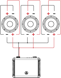

Three DVC drivers with Voice Coils in Parallel / Parallel
Photo Wiring Three DVC drivers in Par_Par
Three Dual Voice Coil Speakers in Parallel / Parallel
Connecting the two voice coils of each driver in parallel (+ to +, - to -) and the drivers themselves in parallel will result in the following impedances:
  • Dual–8 Ohm Subwoofers: 1.33 Ohms
  • Dual-6 Ohm Subwoofers: 1 Ohm
  • Dual–4 Ohm Subwoofers: 0.67 Ohm
  • Dual–2 Ohm Subwoofers: 0.33 Ohm
  • Dual–1.5 Ohm Subwoofer: 0.25 Ohm

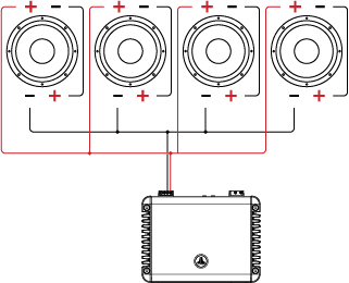

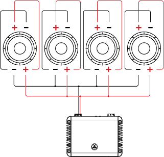

Four DVC drivers with Voice Coils in Series / Parallel
Photo Wiring Four DVC drivers Ser_Par
Four Dual Voice Coil Speakers in Series / Parallel
Connecting the two voice coils of each driver in series (+ to -) and the drivers themselves in parallel (+ to +, etc.) will result in the following impedances:
  • Dual–8 Ohm Subwoofers: 4 Ohms
  • Dual-6 Ohm Subwoofers: 3 Ohms
  • Dual–4 Ohm Subwoofers: 2 Ohms
  • Dual–2 Ohm Subwoofers: 1 Ohm
  • Dual–1.5 Ohm Subwoofers: 0.75 Ohm

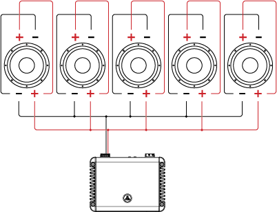

Five DVC drivers with Voice Coils in Parallel / Parallel
photo Wiring Five DVC drivers in Par_Par
Five Dual Voice Coil Speakers in Parallel / Parallel
  • Dual–8 Ohm Subwoofers: 0.8 Ohm
  • Dual-6 Ohm Subwoofers: 0.6 Ohm
  • Dual–4 Ohm Subwoofers: 0.4 Ohm
  • Dual–2 Ohm Subwoofers: 0.2 Ohm
  • Dual–1.5 Ohm Subwoofer: 0.15 Ohm

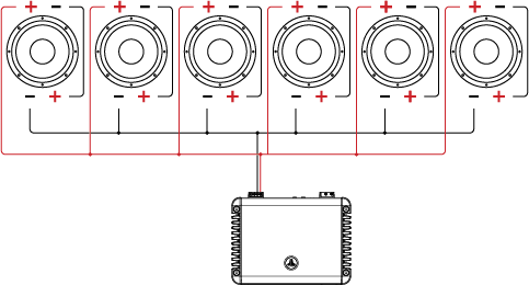

Six DVC drivers with Voice Coils in Series / Parallel
Photo Wiring Six DVC drivers Ser_Par
Six Dual Voice Coil Speakers in Series / Parallel
  • Dual–8 Ohm Subwoofers: 2.67 Ohms
  • Dual-6 Ohm Subwoofers: 2 Ohms
  • Dual–4 Ohm Subwoofers: 1.3 Ohms
  • Dual–2 Ohm Subwoofers: 0.7 Ohm
  • Dual–1.5 Ohm Subwoofer: 0.5 Ohm

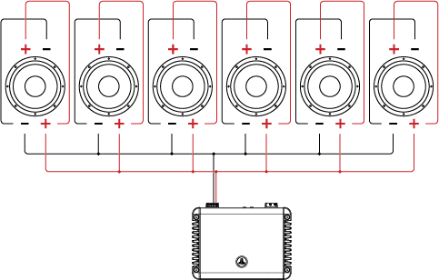

Six DVC drivers with Voice Coils in Parallel / Parallel
Photo Wiring Six DVC drivers in Par_Par
Six Dual Voice Coil Speakers in Parallel / Parallel
  • Dual–8 Ohm Subwoofers: 0.67 Ohm
  • Dual-6 Ohm Subwoofers: 0.5 Ohm
  • Dual–4 Ohm Subwoofers: 0.33 Ohm
  • Dual–2 Ohm Subwoofers: 0.167 Ohm
  • Dual–1.5 Ohm Subwoofer: 0.125 Ohm
