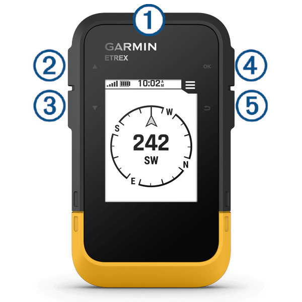

    NOTE: The eTrex SE is pictured below, but the button layout and functions are the same on the eTrex Solar.
    eTrex SE Button Layout
    ONE
    Power Button
    POWER
    Press and hold to turn the device on.
    While powered on, quickly press to turn the backlight on or off.
    Press and hold to open the power menu.
    TWO
    inReach Mini Up button
    UP
    Press to scroll through menus, options, and settings.
    THREE
    inReach Mini Down Button
    DOWN
    FOUR
    Upside Down Teardrop
    OK
    Press to choose an option or open the menu for a page.
    Hold to save your current location as a waypoint
    FIVE
    Back Arrow
    Widget Glance List
    BACK
    Press to return to the previous page.
    Hold to view the glance loop.
