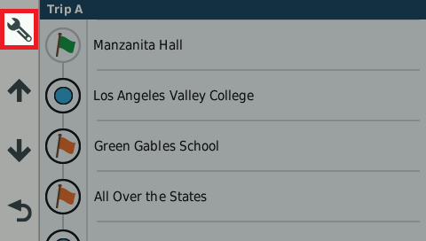

To Edit a Trip

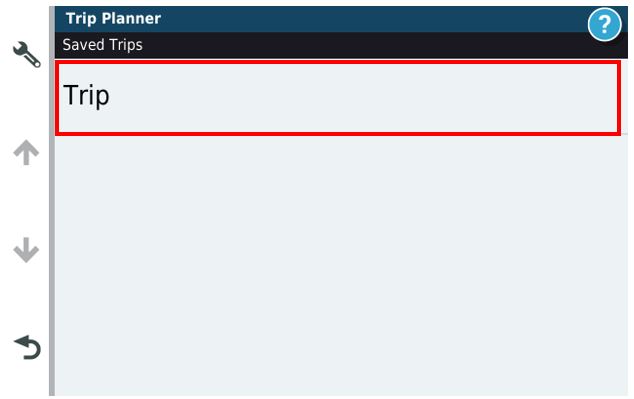

1. Touch Apps
2. Touch Trip Planner. If necessary, touch the  down arrow to scroll until the Trip Planner appears
3. Touch the name of the trip
4. To edit the locations, touch a location and choose an option. Click on Editing Options below to see the options available.
Editing Options
  • Touch the add icon to add a stop between locations.
  • Touch the  wrench icon to change a location.
  • Touch to change the order of points.
    • Touch and hold the  move icon next to a point and drag it to a location on the list.
NOTE: To reverse the order of the trip, the order of points would need to be rearranged manually.  This would replace the trip originally entered and would not create a new trip.
  • Touch the orange flag icon to convert a waypoint into a shaping point.
    • This builds a route passing through that point without navigating to it.
    • The icon will change to a   blue shaping point icon and the route will recalculate.
  • Touch the  delete icon to remove a point.
    • Then touch Yes.
5. Touch the  wrench icon for more editing options
Select from the following options:
  • Route Preference: Sets the preferred way to route the trip.
  • Shape Route
  • Optimize Order: Calculates the most efficient order to travel to all the points.
    • The start and end points will not be changed.
    • You must have at least four points.
  • View Turns: View a list of turn-by-turn directions in the trip.
  • Delete Trip
  • Rename Trip
  • Edit Schedule: Changes the departure and arrival times.
The trip will now be changed. When the trip has been edited to your satisfaction, touch Go! to proceed with navigation.

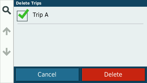

To Delete a Trip
1. Touch Apps
3. Touch the wrench icon
4. Touch Delete Trips
5. Touch the trip(s) to delete to place a  checkmark next to them, then touch Delete
6. Touch Yes
The trip(s) will now be deleted.
To Navigate a Trip Using Trip Planner
1. Select Apps
2. Select Trip Planner
5. Select the Trip
6. Touch Go
