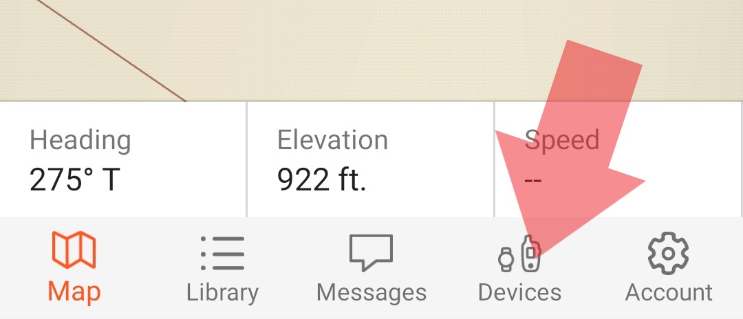

  1. Ensure your inReach device is powered on and paired with the Garmin Explore App
  2. Select Devices
    Indicating Devices Selection

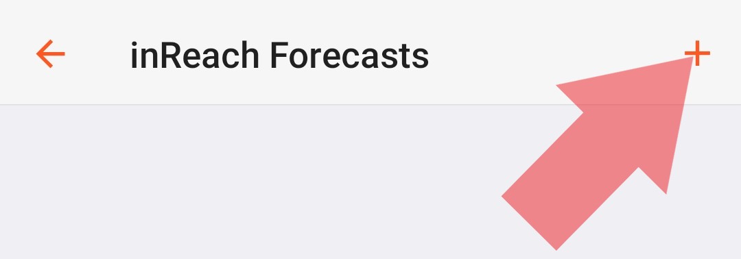

  4. Select the + symbol
    Indicating Add Icon

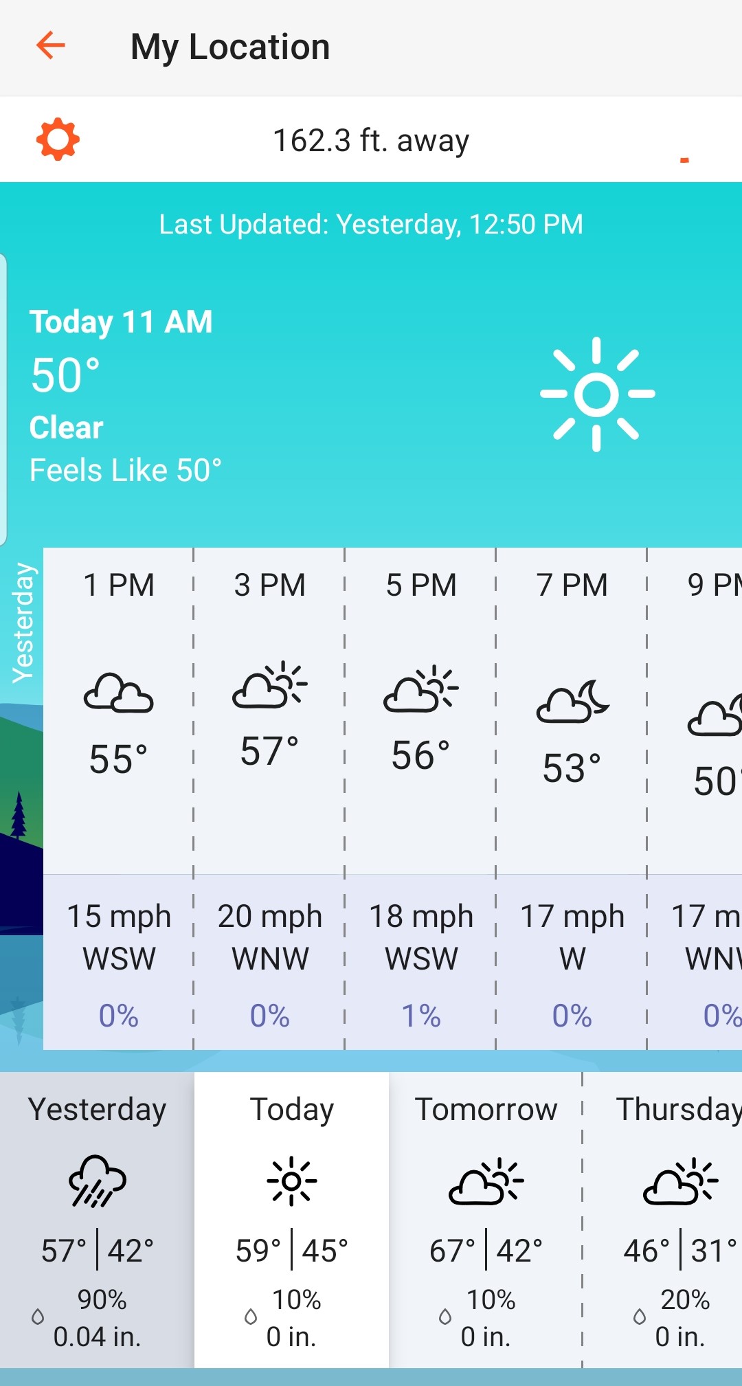

  6. Once weather has been received, the page will update with the weather
    Weather Forecast

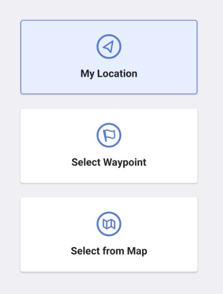

  6. Choose between My Location, Select Waypoint, or Select from Map
    Weather Location Options

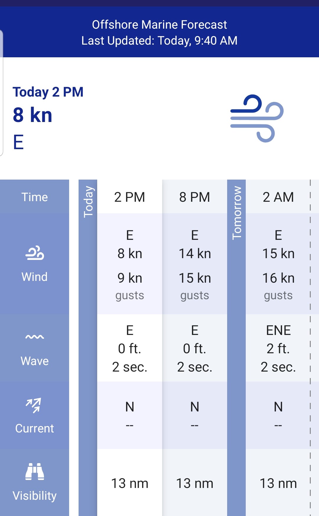

  • Once weather has been received, the page will update with the weather
    Marine Weather Forecast
Note: Marine weather is designed for deep waters and can only be requested if you or the selected location is at least 5 miles from shore. Depending on the large inlets or nearby land masses, you may not be able to retrieve Marine weather. If you are having problems requesting Marine weather, use steps in selected location and move the point further from shore.
