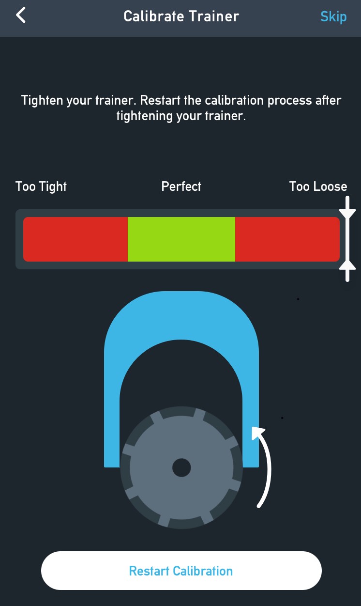

If you open the app, attempt to perform a calibration, and you notice the calibration measure is far to the right as shown below:
Tacx Training app calibration screen. Arrows in red not green showing too loose.
You will need to confirm the following:
  • You are using a trainer tire (not older than 1 year). (See: Rear Tire Tips When Using an Wheel-On Trainer)
  • The rear tire is inflated to the max pressure recommended for the wheel and tire system.
  • You selected the correct position when placing the trainer resistance unit on the frame stand.
  • If the brake calibration is showing as too tight, you can loosen by turning the adjustment knob to the right.
