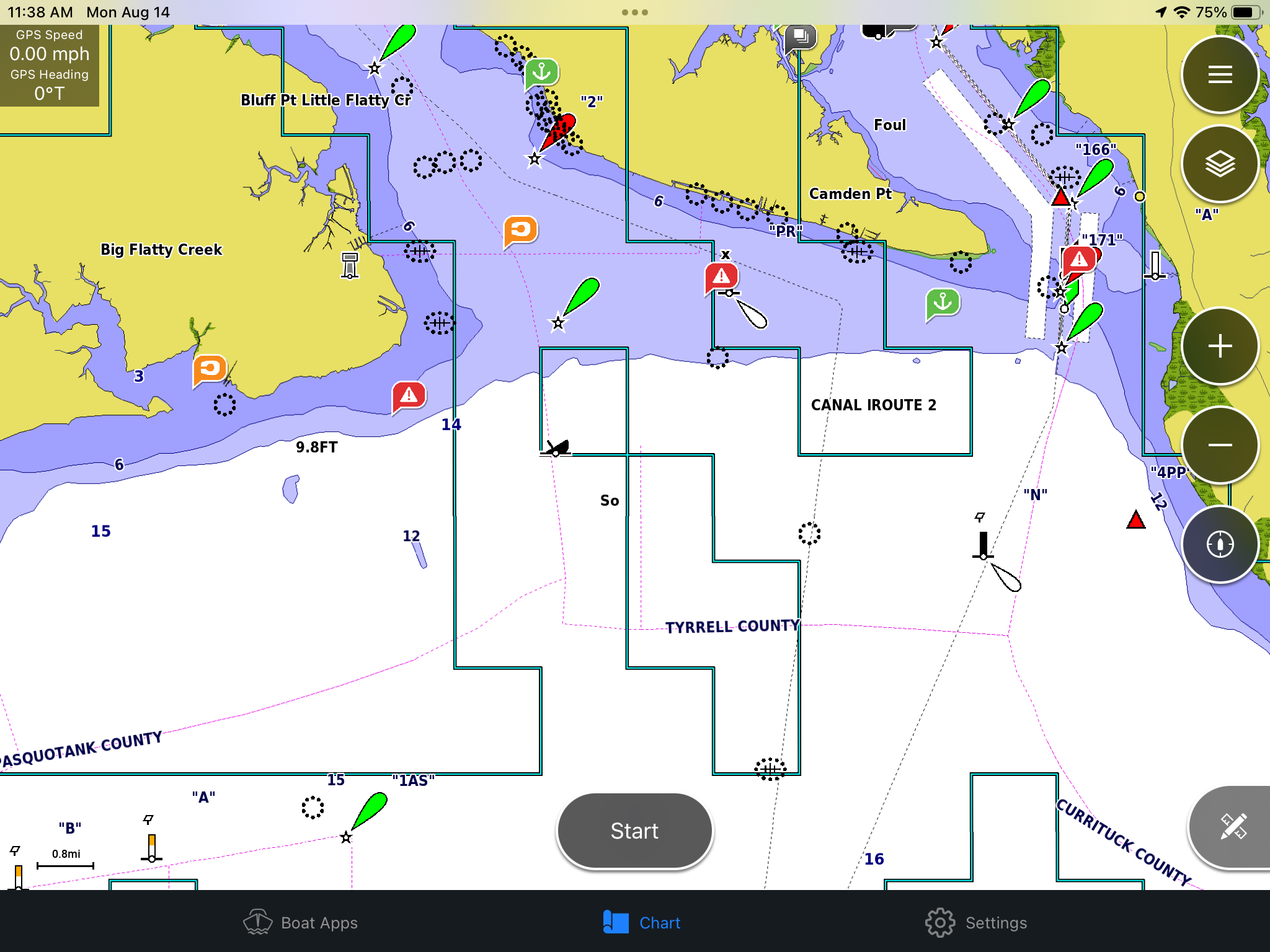

Navigation Chart
Navigation chart with Quickdraw Contour lines on displayed on chart

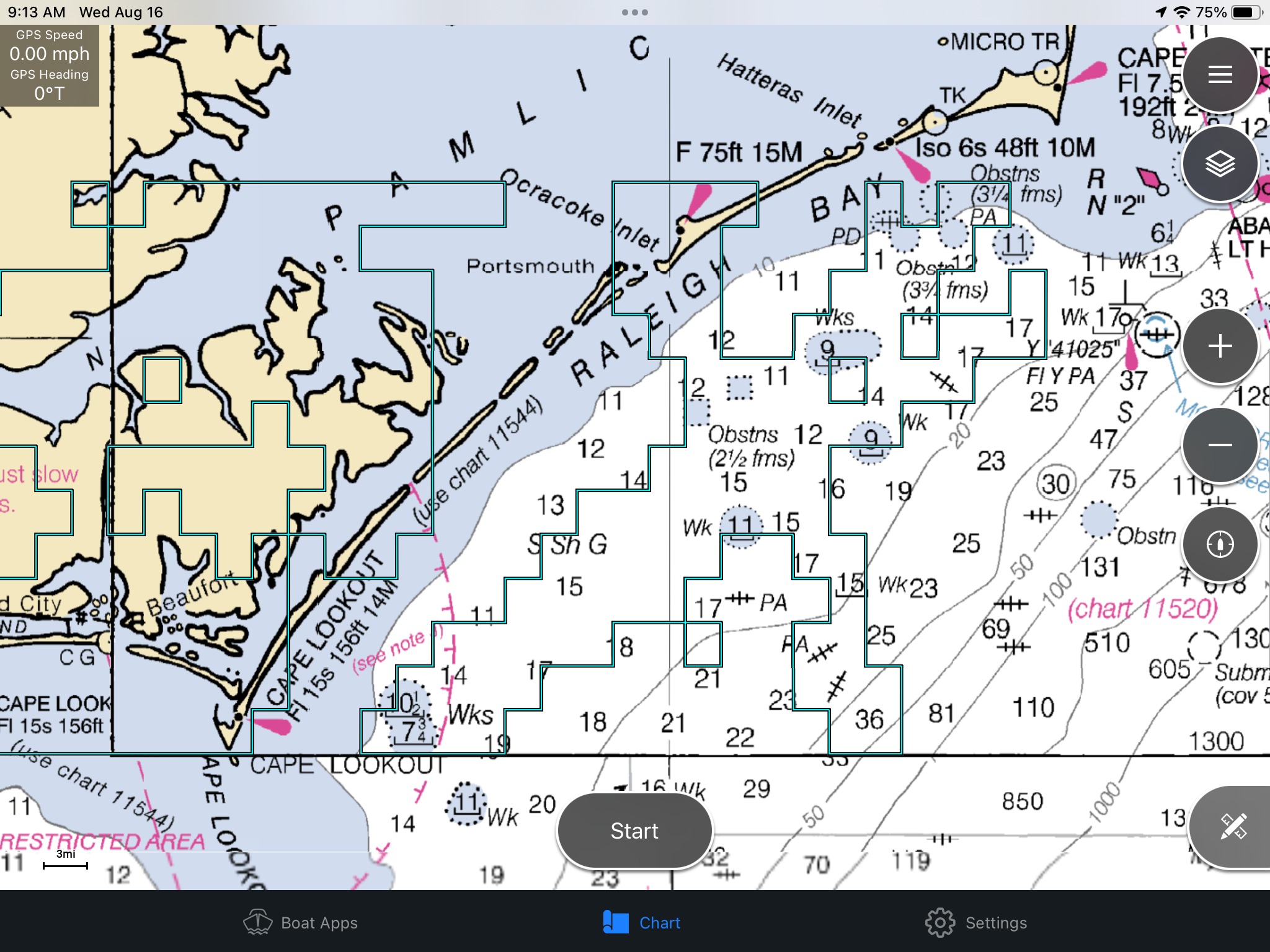

Raster Chart
 shows image of Raster chart with Quickdraw Contour lines

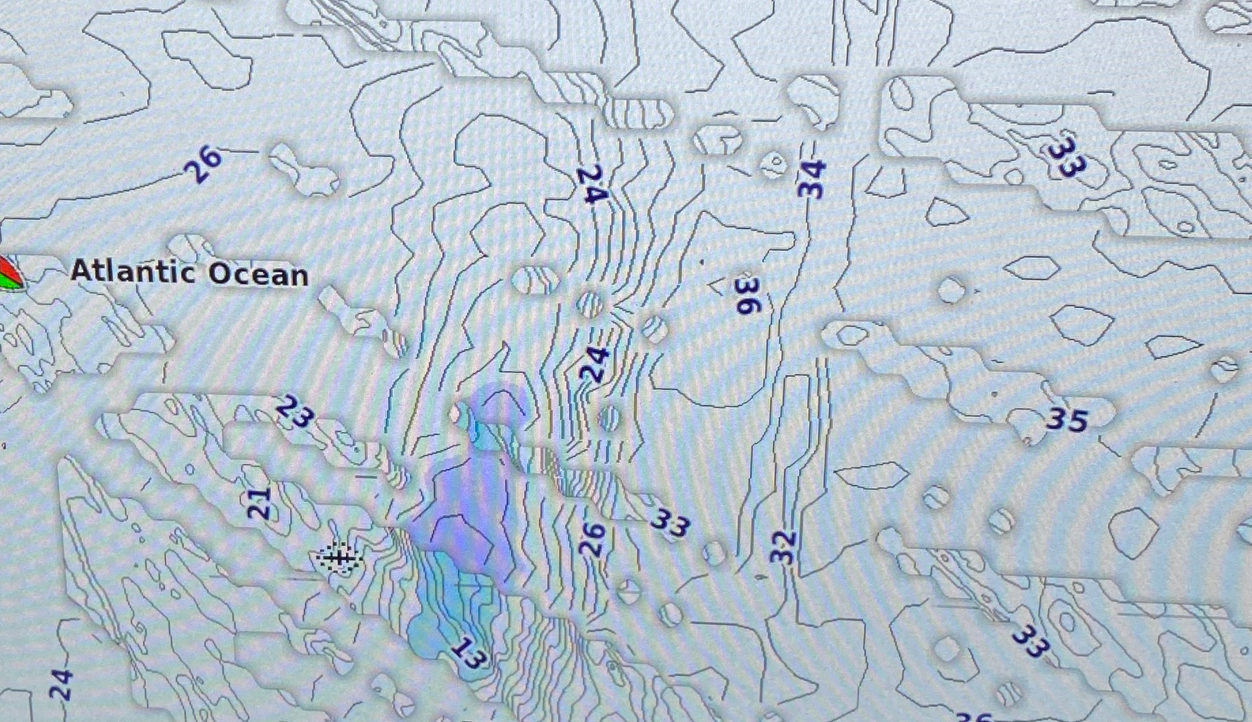

Fishing Chart - blocks on the fishing chart are wavy rather than square or rectangular
Fishing chart blocks
