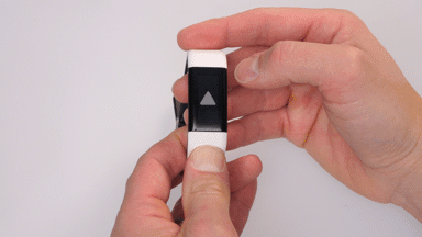

Approach® S40 | Approach® S42 Watches
  1. With the watch powered off, hold the button for a second to power it on (a triangle will appear).
  2. After the first vibration occurs, immediately hold the button.
    IMPORTANT: If you wait too long after the vibration to hold the button, the watch will load to the Settings menu on the watch.
  3. Wait for a second vibration and release the button.
  4. Wait for a third vibration and hold the button.
  5. Wait for a fourth vibration and release the button.
  6. Wait for the watch to reset (this can take up to 15 minutes).

Approach® X10 | Approach® X40 Watches
  1. Power the watch off by pressing and holding the device key until the screen goes blank.
  2. Power the watch on by pressing the device key.
  3. After one second, press and hold the device key until the watch vibrates.
  4. Quickly tap the screen approximately 10 times until the watch vibrates a second time.
The second vibration will confirm that operation was successful and the watch will now boot up in regular mode. The GIF images below display the process from steps 2-4.
Approach X40 Unprompted Factory Reset
Approach X40 Unprompted Factory Reset Tapping Screen
