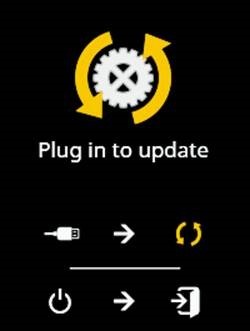

  3. The device will power on into Firmware Update Mode.
    Image Showing Plug In To Update
  4. Press and release the SOS button and you will see the LED flash Green and Red.
    NOTE: Verify the device is in Firmware Update mode as shown in the image above.
