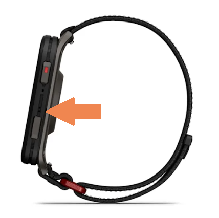

Venu® X1
Button side of Venu X1 with arrow pointing in between the two buttons
