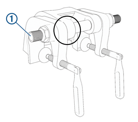

The trim and tilt mount where the mild tilt tube is installed has plastic washers inside that are easily misaligned or could be damaged when replacing the tilt tube. The following steps will help conduct the project and protect the plastic washers inside the mount. See the circled area for washer placement.
Tilt mount
  1. Add a support or jack under the skeg
  2. Loosen the nut to the end of the mild steel tube
  3. Use a soft hammer or place a wood block between the end of the mild steel tube and hammer until the nut is flush with the frame. This protects the end of the mild steel tube
  4. Place the nut on the end of the new stainless steel tilt tube (hammer end)
  5. Use a soft hammer or block of wood to follow the mild steel-tube through the rest of the way and install the new stainless-steel tube
  6. Tighten the nut when the new stainless steel tube is installed
