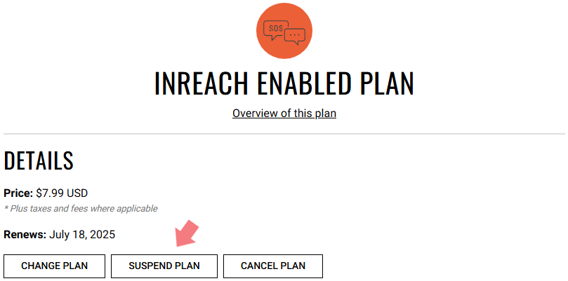

Suspending inReach Service Using the Garmin Website
  1. Log in to the Subscription Portal.
    • When signed into your account at Garmin.com, the Subscription Portal can also be accessed by selecting Account Profile Icon in the top right corner of the page, then Account. From there select SUBSCRIPTIONS & SERVICE PLANS on the left of the page.
  2. Select MANAGE on the subscription you want to update.
    Manage Button
  3. Select CHANGE PLAN.
    WebinReachPlanChange
  4. Select SUSPEND SERVICE.
  5. Follow the prompts to finish suspending your plan.
    • If you are currently on an Enabled, Essential, Standard, or Premium plan, select ACCEPT & CONTINUE, then COMPLETE PLAN CHANGE.
    • I you are currently on a Freedom Safety, Freedom Recreation, or Freedom Expedition plan, check the box for Confirm Plan Change, then select SUSPEND SERVICE > CONTINUE.
A confirmation email of the suspension will be sent to the account email.
