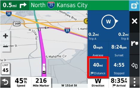

  4. Access the Trip Data by touching the data field that displays Speed
The Trip Data will display on the right side of the map screen.
If the Distance isn't Listed, Select One of the Data Fields to Change to Distance.
