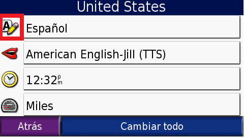

1. Touch the Wrench icon on the upper or lower right side of the screen with the Magnifying Glass and Map icons
2. Touch the Clock/Red Lips icon
3. Touch the First option (next to the A / Pencil icon)

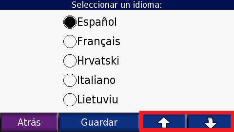

4. Touch the up or down arrow until you find the desired language
5. Touch the desired language and touch OK
    • If text language is not in English, this is the middle button
The device should now be in the selected text language.
