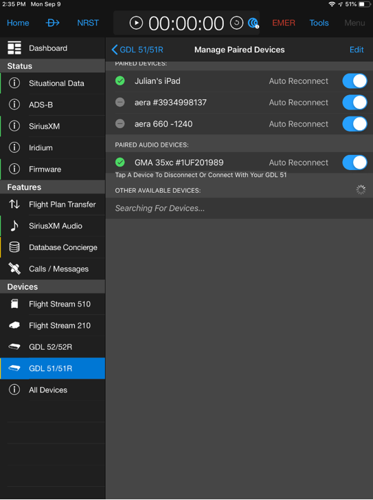

  3. On the Devices page of Garmin Pilot, select the GDL® data transceiver that is connected via Bluetooth.
    • devices 1
  4. From the GDL device page, select Manage Paired Devices option as located on the bottom right of the screen.
  5. The Manage Paired Devices page will display the devices the GDL had been connected to, as well as search for new devices to connect.
    • If the desired Audio Device is in active pairing mode, then it will display on the bottom list of discoverable devices.
    • If the device is listed, select it to pair it to the GDL.
  6. The paired Audio Device will show connected under the Paired Audio Devices group.

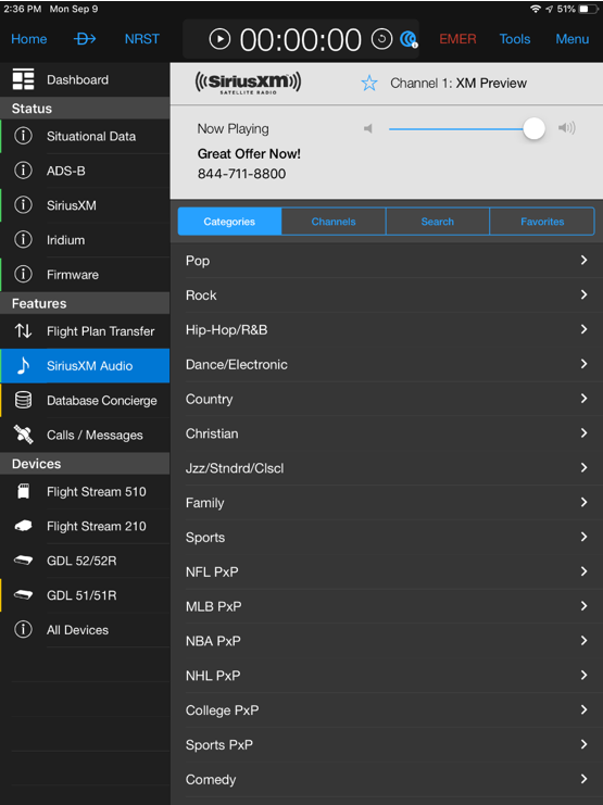

  7. Select SiriusXM Audio on the left of the screen to control volume and radio stations.
