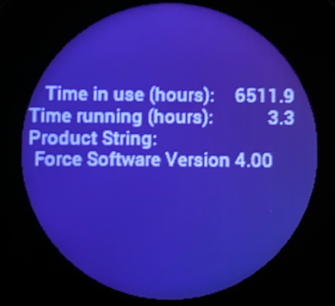

- Pair the remote with the system Select Menu > About > Press cruise control (upper left button) eight times fast => Info
- If the remote displays the run time of the motor, it is properly communicating with the unit. Contact Marine Product Support

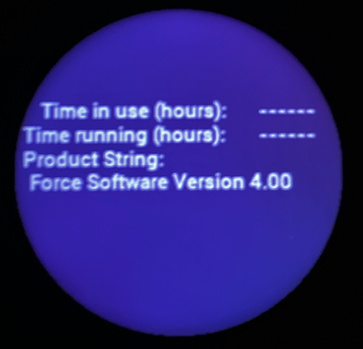

If the remote displays nothing, contact Marine Product Support
