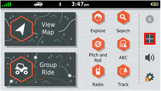

1. Touch Apps

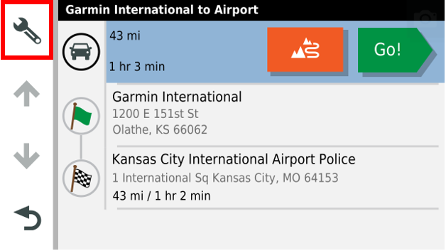

3. Touch the trip you would like to add the attractions to
4. Touch the Wrench icon

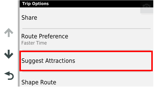

5. Touch Suggest Attractions

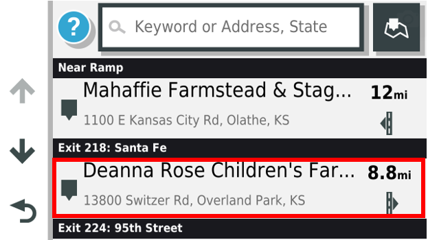

6. Touch the desired attraction
    • You can search for specific attractions by touching the search box at the top of the screen

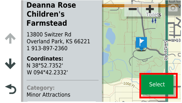

7. Touch Select to add the attraction

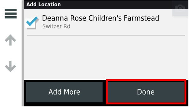

8. Touch Done to confirm
The device will recalculate the route with the chosen attraction added.
