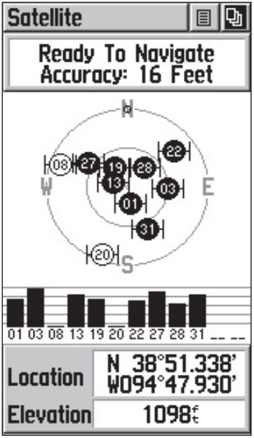

The unit may take up to 5 minutes to establish a position the first time you use it outside with a clear view of the sky. After that, it should take only 15 to 45 seconds. When the eTrex Legend handheld has acquired enough satellite signals to determine your location, a “Ready To Navigate” message and your location coordinates and elevation are shown.
eTrex Legend Satellite Page
