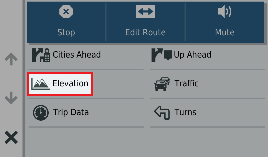

1. Touch View Map
2. Touch the  menu icon in the lower right corner
3. Touch Elevation
4. Touch the chart to expand it to full-screen mode
The device will now display the current elevation, distance to the next steep grade, and a chart of elevation over distance.
