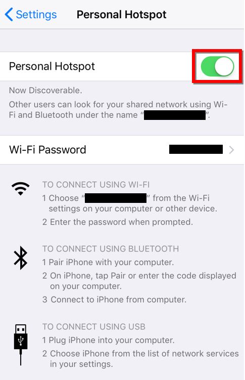

Inspector's Phone:
1. Go into the phone's Settings menu, and turn on Personal Hotspot

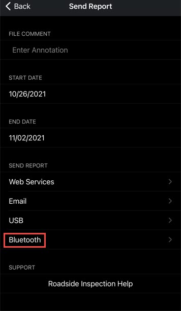

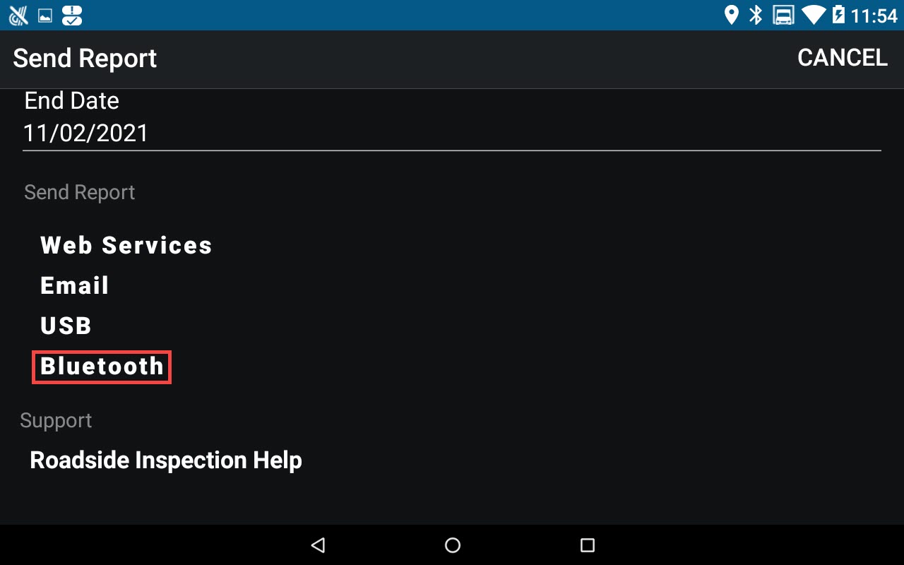

8. Change the date range if necessary
9. Touch Bluetooth

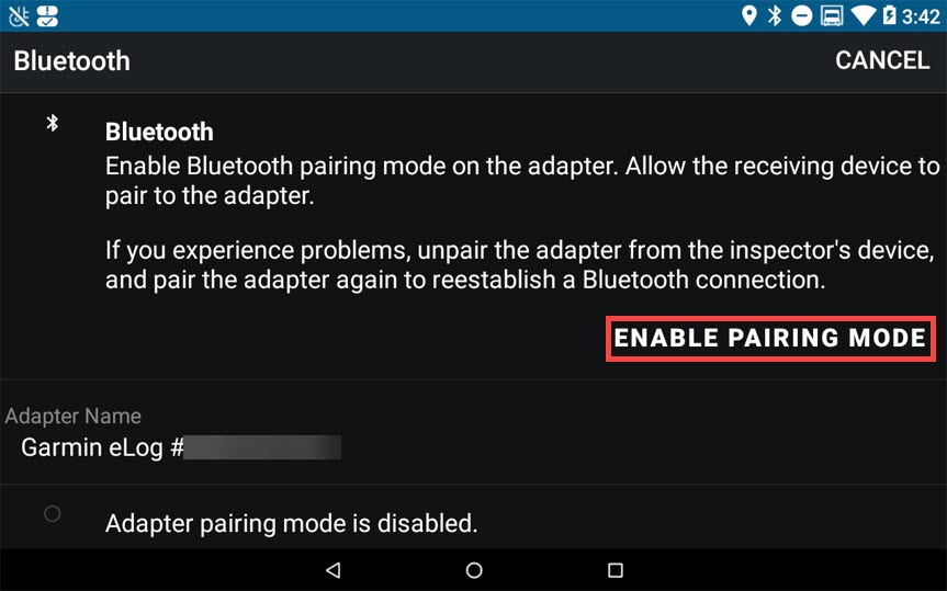

10. Touch Enable Pairing Mode

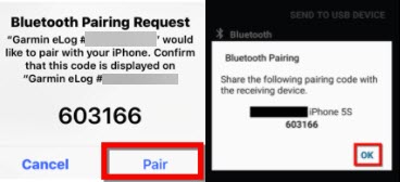

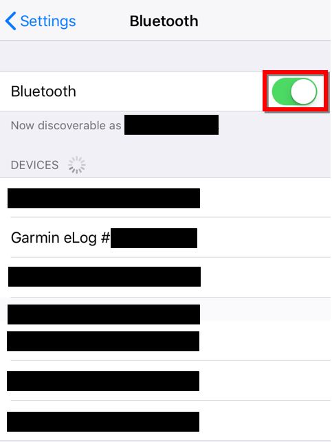

Inspector's Phone:

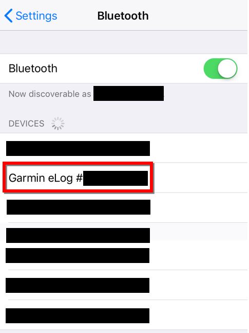

11. Navigate to the phone's Bluetooth settings menu, and turn Bluetooth on
12. Touch the Garmin eLog when it appears
13. Verify the pairing code, then touch Pair or OK

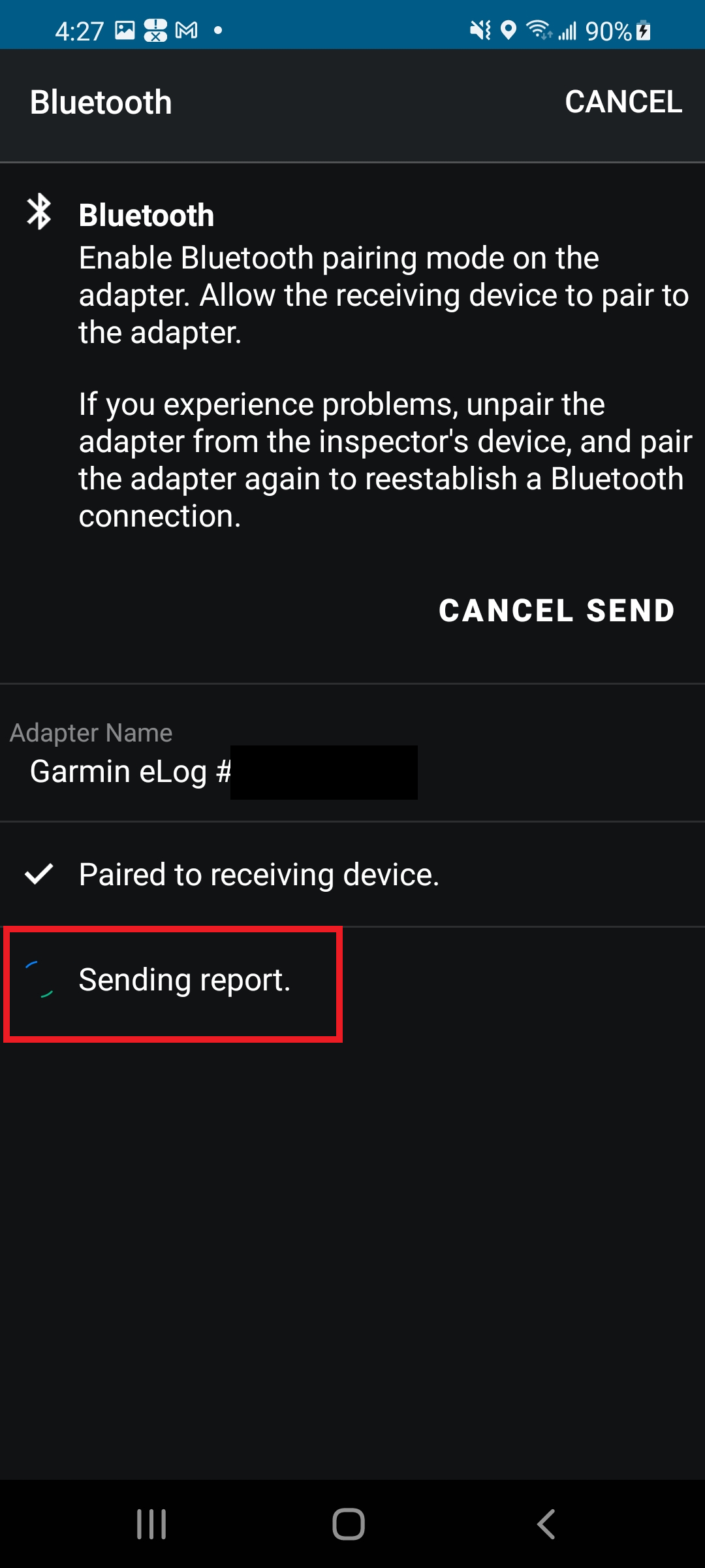

Your Garmin eLog App:

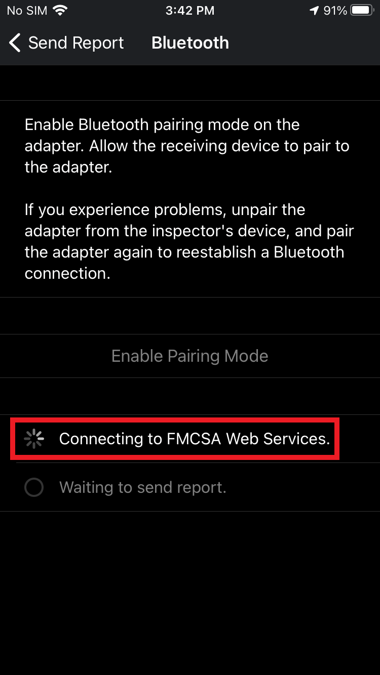

14. The eLog app should begin connecting to the FMCSA Web Services

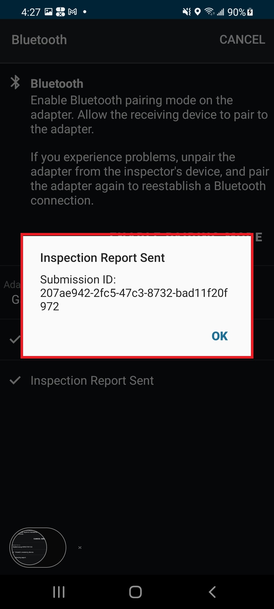

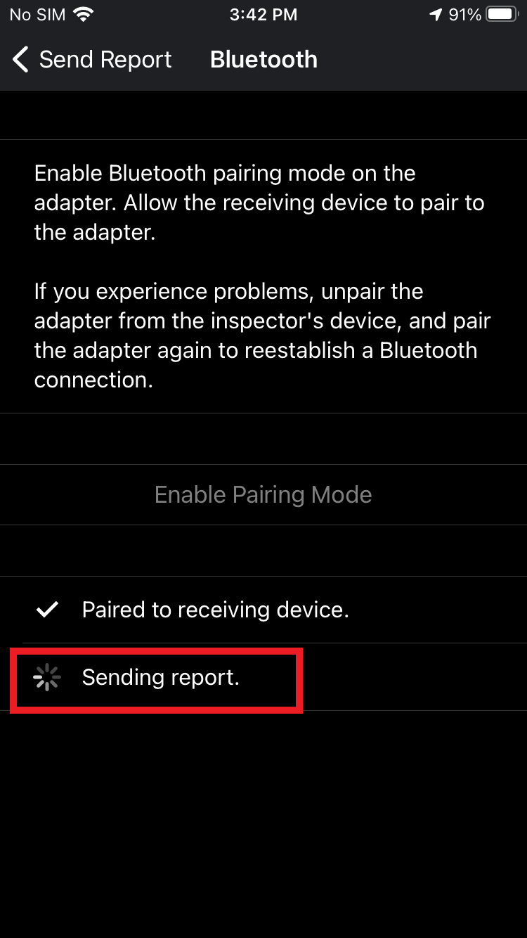

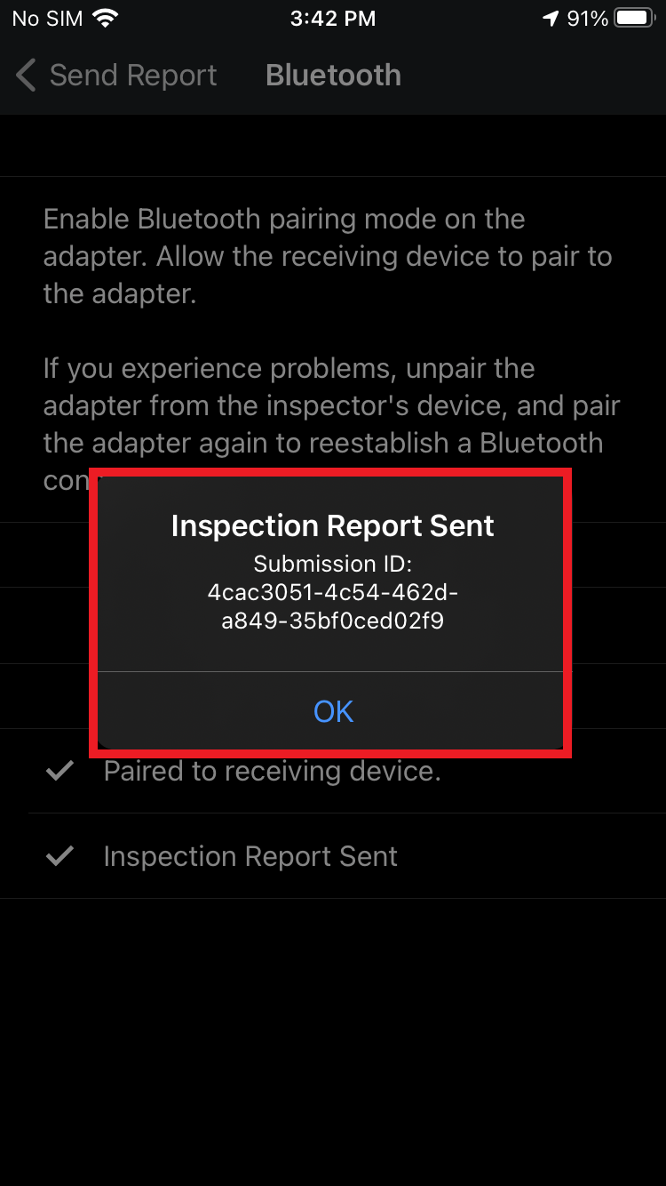

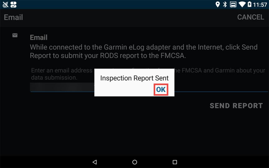

15. The eLog app will send the inspection report
16. A confirmation will appear with a unique submission ID. Touch OK. The report has been sent.

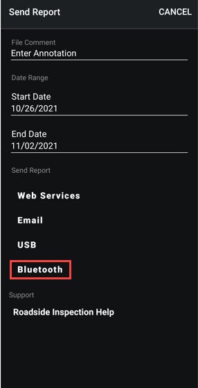

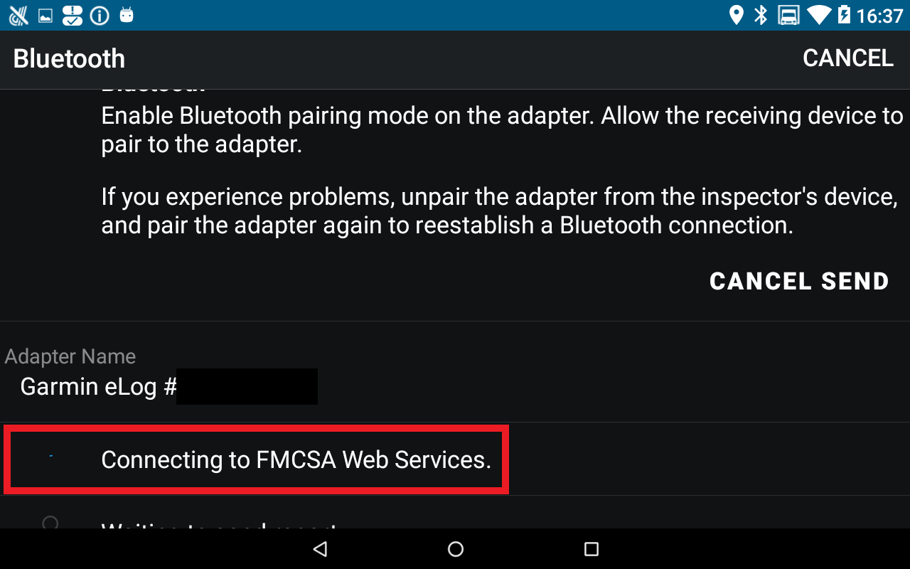

7. Enter an annotation if necessary
    • Any key phrase or code provided by the DOT officer during the inspection should be entered here
      • Special characters and spaces are not permitted and there is a maximum of 60 characters
9. Touch Bluetooth
