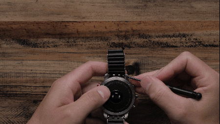

  1. Use the quick release lever to remove the band from the watch body
    Chronos Replacement GIF 1

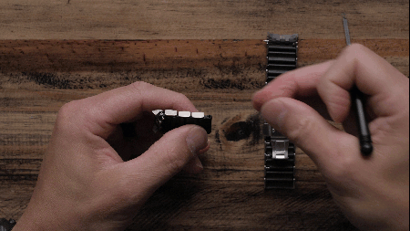

  2. Use the spring bar removal tool to remove the pin from one of the links
    Note: Repeat this process for any links that need removed
    Chronos Replacement GIF 2

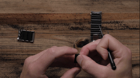

  3. Reconnect the links using the spring bar tool to fit the spring bar into place
    Chronos Replacement GIF 3
    Note: Repeat this process for any links that need replaced
  3. Remove the band pin
    Chronos Replacement GIF 4
  4. Insert the band pin into the new rubber link
    Chronos Replacement GIF 5
  5. Reconnect the links using the spring bar tool to fit the spring bar into place
