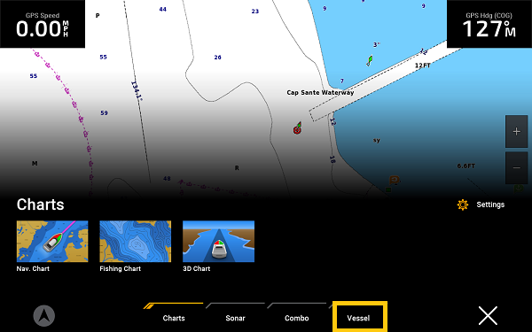

Navigating to the Media page

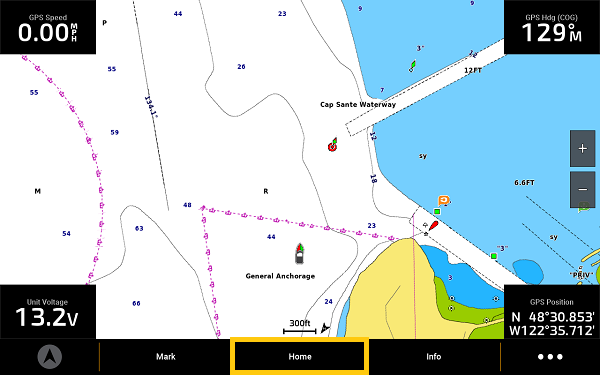

  1. Select Home
    chart screen - home button highlighted
  2. Select Vessel
    chart screen - vessel button highlighted

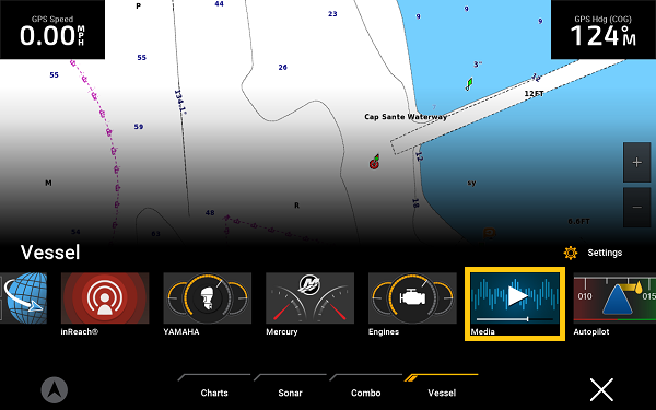

  3. Select Media
    vessel screen - media button highlighted media screen

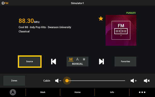

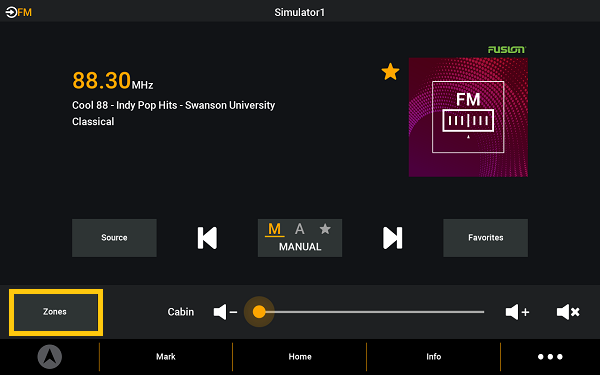

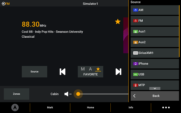

Source and Zones
Source and Zones appear at all times on the main Media page

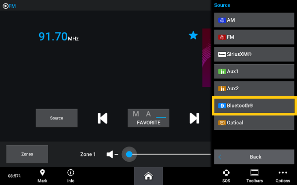

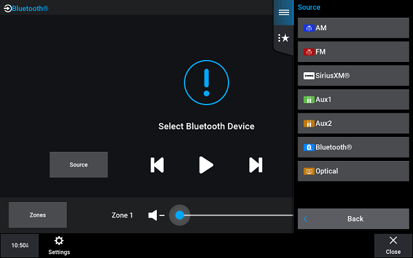

  • Source allows a different source of audio available to the stereo to be chosen
    media screen - source button highlighted media screen - sources opened

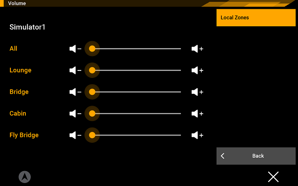

  • Zones allows the volume of individual zones or all zones at once to be adjusted
    media screen - zones highlighted zones screen

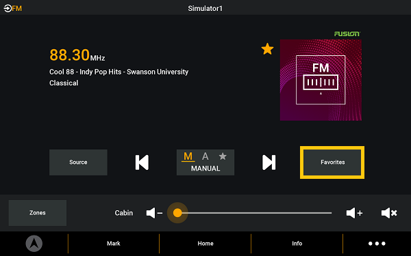

AM and FM Source

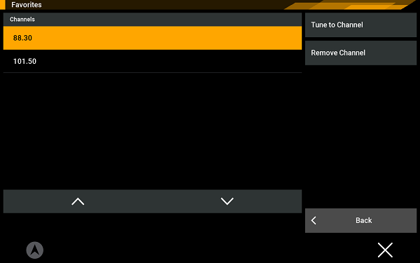

  • Favorites shows all favorited stations
    media screen - favorites button highlighted media - favorites screen

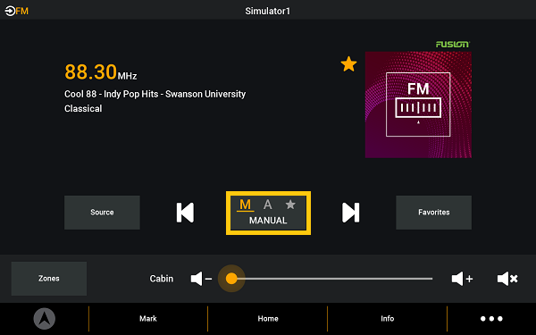

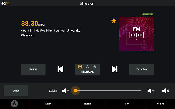

  • Select the scanning mode button to change how the stereo scans for stations
    media screen - tuning mode button highlighted
    • M allows manual scanning to any frequency
      media screen - tuning mode m selected
    • A automatically scans to the next available station
      media screen - tuning mode a selected
    • Star scans to the next favorited station
      media screen - tuning mode star selected

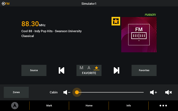

  • Tune to a station and select the star icon to favorite it
    media screen - star button highlighted

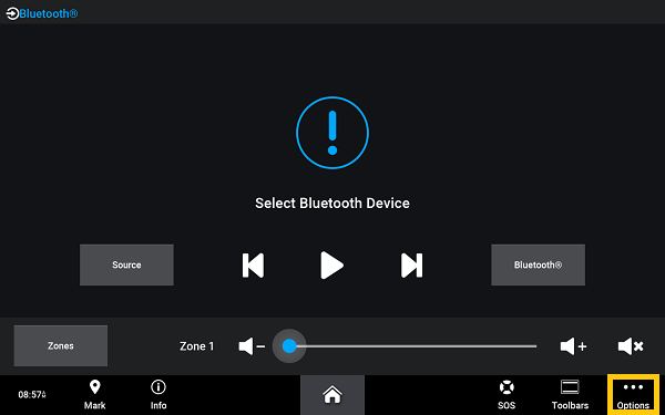

Bluetooth Source
  1. Select Source > Bluetooth
    media screen - source button highlighted media source screen - bluetooth highlighted

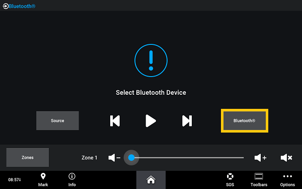

  2. Select Bluetooth again
    bluetooth media screen - bluetooth highlighted

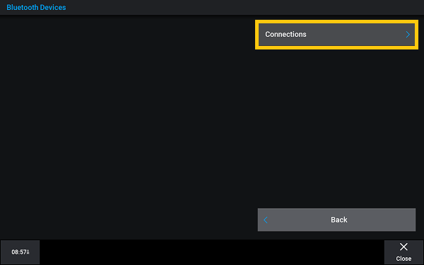

  3. Select Connections
    bluetooth screen - connections highlighted

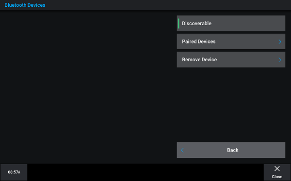

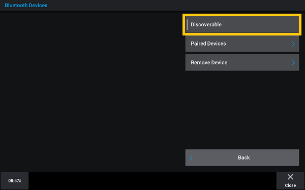

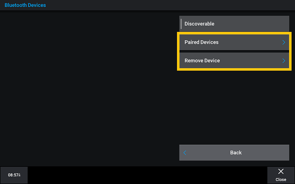

  4. Select Discoverable to make the stereo discoverable via Bluetooth
    bluetooth connections screen - discoverable highlighted bluetooth connections screen - discoverable on
  • The options to show Paired Devices and Remove Paired Devices also appear here
    paired devices and remove device highlighted

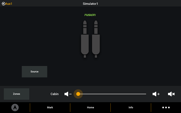

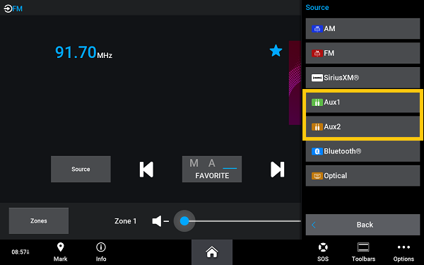

Auxiliary Source
  • Plays audio from a device connected to the Auxiliary port
    media source page - aux 1 and aux 2 highlighted media page - aux source
Options menu
  • From the media page, select Options
    media page - options highlighted media page - options selected

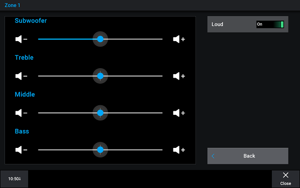

  • Audio Levels adjusts the Subwoofer, Treble, Middle, and Bass
    audio levels page
  • The Loud setting maintains frequency response at low volumes and increases perceived loudness at high volumes
    • Loud is enabled by default in all zones

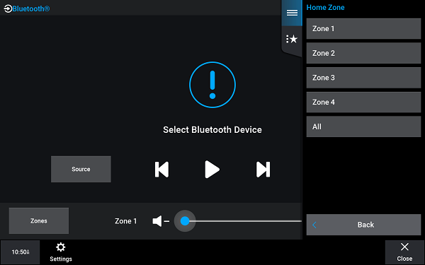

  • Home Zone changes which zone from which connected media device is adjusted by default when adjusting volume
    select home zone on ra770

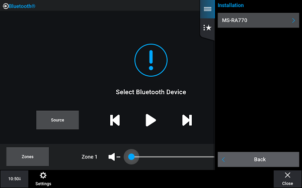

  • Installation chooses which connected stereo or other media device is being controlled
    media page options - installation selected
